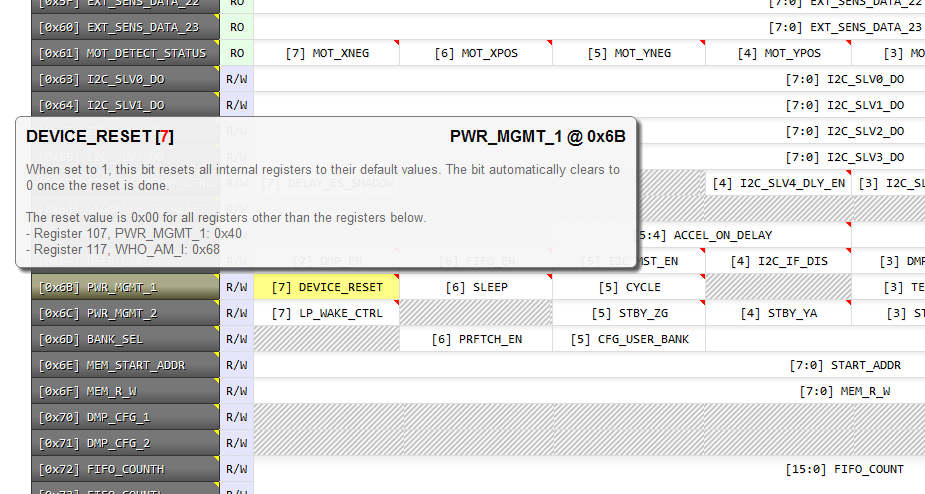

The I2Cdevlib project also aims to include detailed register information for every device in its database, which allows for rich interactive register maps like this:
(This particular image shows data for the MPU-6050, visible here)
This dynamic register info will shortly be able to be used to automatically create device class code, not just for Arduinos, but ultimately for other platforms like PIC, ARM, MSP430, etc.
