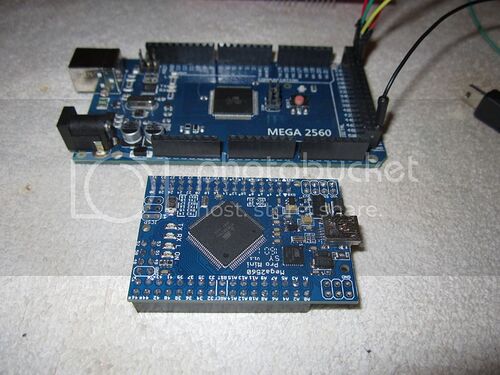

Coat tailing this discussion, I just purchased a Mega2560 Pro Mini and, so far, things seem to work between the two boards without modification. The Pro Mini is considerably smaller, as can be seen in the photo:
econjack:
I didn't know there was such an animal. Looks good. I might have to get myself a couple.
