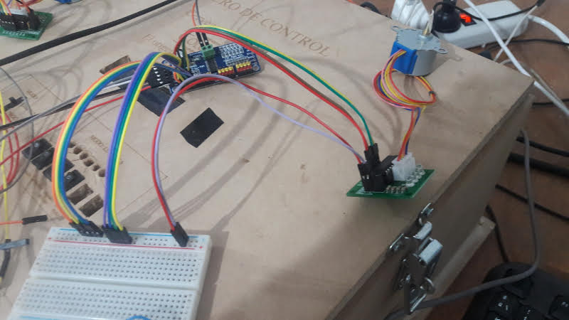

Hi, How are you?, sorry for asking, But i was wondering, do you know if you can control 3 stepper motors (28byj-48) with the pca9685?,
There Is a picture of How i have it Connected
I have connected the 4 pins of the driver uln2003 (in1,in2,in3,in4) to the pca9685 using 4 pwm pins, and the 4 (v+) of those pwm pins to the (+) of the driver, and ti did the same for the gnd, is thAt correct?
Could you please tell me if it is possible?, and if it is possible, could you please help me with the Code?,
Thank you for all your help, i really appreciate it
