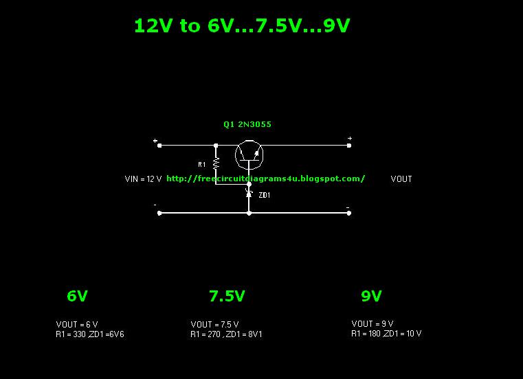

Wouldn't this circuit work? then the heat wouldn't be in the arduino board? My outputs off the arduino will not be driving any motors or anything, they will be sending a voltage to a logging system only, not sure if that makes a difference.
Yes, you can use this ckt in the Vin line to the Arduino bd to drop the voltage. Now the heat will just
be moved to the 2N3055, which are generally huge parts and easy to heatsink if necessary. Try the 7.5V
setting.
