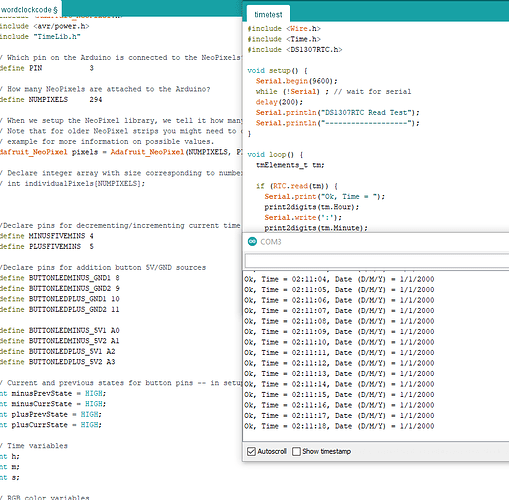

Screwing around trying to get the time to display on this LCD just to understand. Can't even get this right

I'm not that far off. I have the RTC module hooked up and I can get the current time. I just don't know how to modify the original code to incorporate that info.

Load a time setting sketch from the library, set the time, load your sketch.

Well, my previous comment about FastLED and the millis count is totally wrong, I just noticed this sketch uses Adafruit_NeoPixel. That library makes NO correction for the lost millis count while updating the LEDs.
millis() was never really intended for keeping track of clock time. Just a general purpose event timer.
So I think I got it now. I used different code from https://www.instructables.com/DIY-Word-Clock-In-Seven-Steps/
and I used a RTC module as suggested.
This is what the final code:
