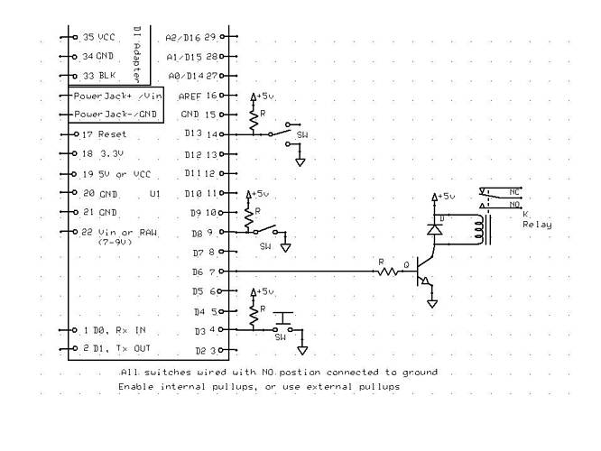

How are you turning on the LED lights?
One way would be like this:
Wire the relay Common & NO pins across the LED control box light on/off switch.
A 5V relay, 1N4004 diode, and 470 ohm resistor and 2N2222 transistor would do the trick.
Might be able to use just the resistor/transistor, hard to say without knowing more about your box.

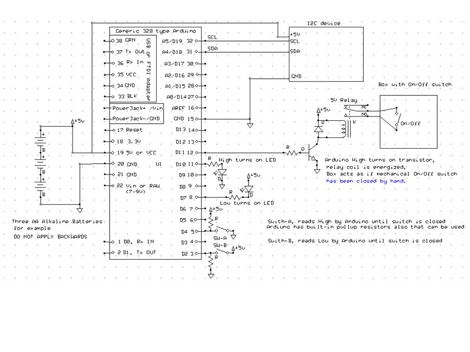

This is pretty straight forward. Do some browsing for I2C interface.
With the gravitech part, you are going to connect 4 wires: +5, GND, SCL and SDA.
SCL & SDA connect to specific pins on the Arduino.
SDA is Analog4
SCL is Analog5.
Then you will invoke Wired.h in your sketch Using IIC (I2C) for interfacing to MAX6953
Arduino analog 5 - I2C SCL
Arduino analog 4 - I2C SDA

As for the LEDs - you have them separeated? They are still in their original congifuration?
Search for a recent post by Mowcius on how he hacked an old MP3 player to install a transistor across its switches to make it play.
You may be able to do that, or you may need a couple more parts like I showed, really depends on your box.
If you are just driving the LEDs individually, i.e. you disassembled the unit, that is simple too. Just need some 270 or 330 ohm resistors.
Wire them up on series: +Voltage source (can be the arduino 5V) to resistor, other end of resistor to LED Anode, LED cathode to arduino pin.
When the pin goes low, the LED turns on. Wire up the resistor to the LED and experiment with +5 & GND (instead of Arduino pin) to start.
It will only turn on one way.
Here are some example hookups you can make. Note that SDA & SCL are supported by hardware in the ATMega chip, they must be connected there.
If you bring in power like this, be sure not to connect it backwards. This bypasses the regulator and the Reverse Voltage protection that would normally take in 9-12V and create 5V.
