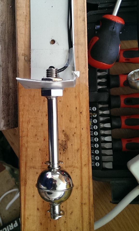

Hi there, never used this Andruino stuff before but having found how accessible (cheap) it is to get into I thought I might give is a go to control a pump removing flood water from my patio/soak-aways.
I could not use a float switch as not enough depth so a fish tank switch was used as a sensor. A relay was procured for the pump activation (mains) and the andruino program used to add some hysterisis.

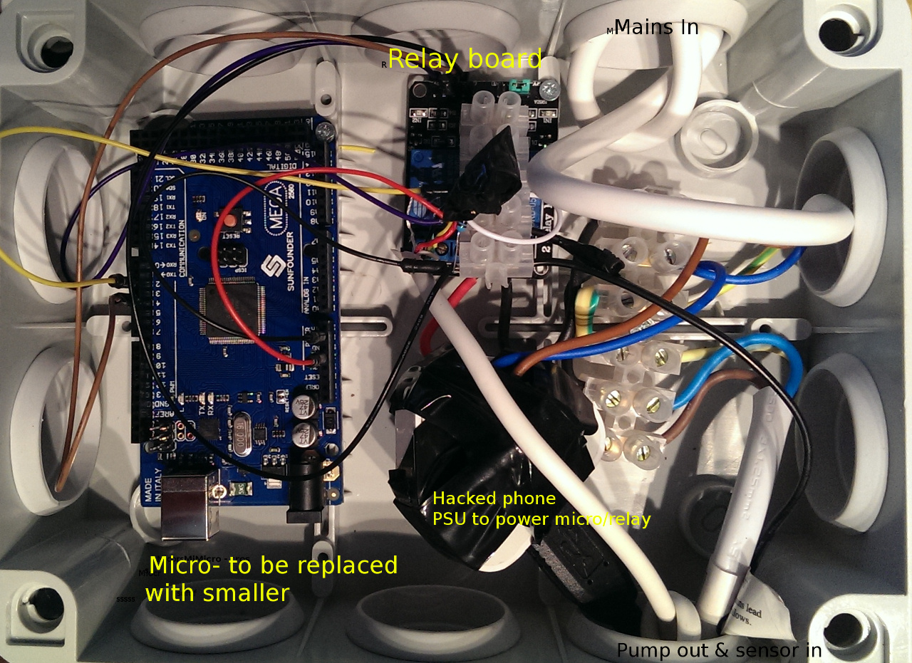

I have powered it from a cheap plugin phone charger (hacked) and it seems to all work - yes it is a quick & dirty hack but time was pressing (and water rising). Just thought I would share. The mega board is overkill and is to be replaced by a nano when it arrives.
To see what the programming was doing I added debug down the serial. Haven't used a soldering Iron in years!
Picture and code follow (code would be pretty printed if the IDE didn't throw a java exception when i asked it to copy).

Thanks for sharing, some small remarks
unsigned long pumpOperationTime = millis()-pumpOnTime;
all timing related values should be unsigned long as millis () returns that type
  if ( digitalRead(sensorPin) )  {
    (void) turnPumpOn( );
    (void) turnPumpOff( );
the cast to void is not needed.
    turnPumpOn( );
    turnPumpOff( );
Hi Rob,
Thanks for the feedback - doh, I should have spotted the time is unsigned.
Best regards,
Simon
Code has been updated and hardware sensor modified (new sensor which works in opposite to the other one).
I have also now managed to use the Arduino mega as an ISP to programme an ATTiny85 which makes this a very cheap microcontroller.
