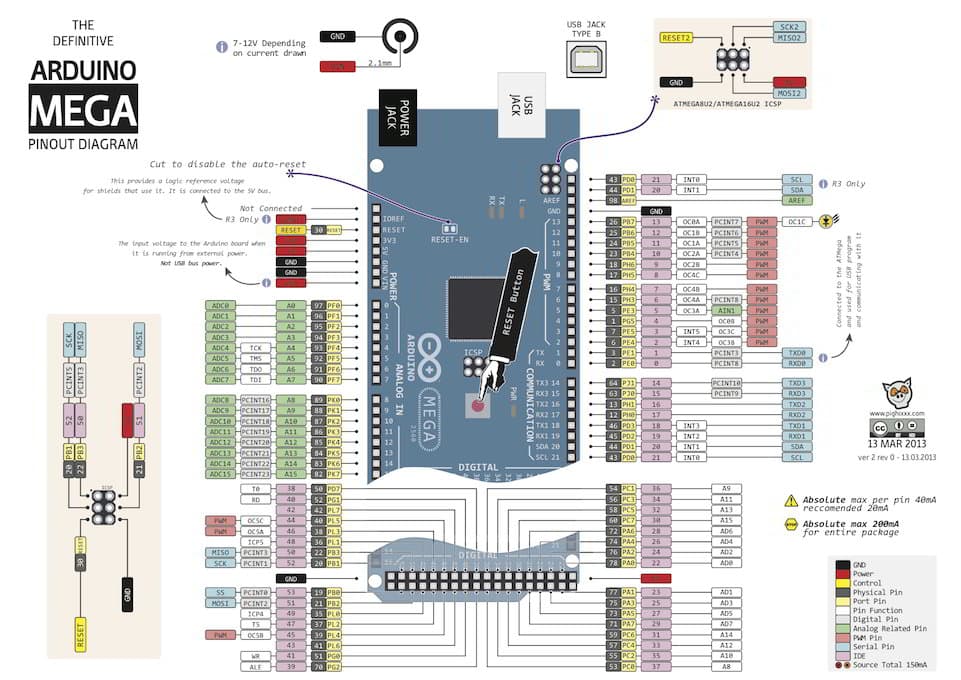

No on a Mega
Does a Mega have pins labelled D0, D1 etc ?
I see D next to digital pins in this diagram i have from Arduino. That is why i askedd about digital pinsd as well.
My question was
Here is a picture of a genuine Mega board
Does it have pins labelled D0, D1 etc ?
No it does not. Point taken.
Thank you!
