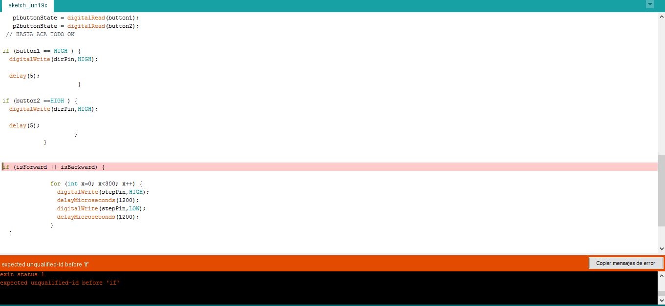

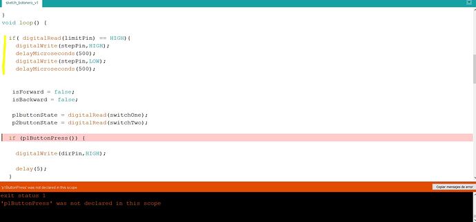

I tried copying
if( digitalRead(limitPin) == HIGH){
digitalWrite(stepPin,HIGH);
delayMicroseconds(500);
digitalWrite(stepPin,LOW);
and to put it in several places of my own code but i get an error message (img attached).
What's highlighted in yellow is what I copied from the other code. I do not know if it is correctly placed or not... or if I have to modify something on it... ( im still very new to all this arduino mambo jambo)
Could anybody please provide me some help/guidance?

How could you possibly expect help if you don't show the problematic code and don't show the error message? It might be something simple but who can tell?
Looks like you might be missing a right curly bracket but who knows?
Sigh,
If this is the complete code, than the compile message should have been a big clue as to why it will not compile. It would be helpful to see this error when posting.
In any event, p1ButtonPress and p2ButtonPress are not defined.
Not sure what there are to be used for.
vaj4088:
I just added as an attached file on the first post the problem itself.
"p1ButtonPress1 was not declared in this scope"
( i honestly don't know what to write there)

Please have a look at the image I attached on the first post.
Whenever I copy and paste the lines highlihgted in yellow, I get the error. If not, the code works fine ( but without the limit switch, of course)
The compiler is screaming the issue. I have told you what is wrong.
The 2 variables are not defined.
Romonaga:
p1ButtonPress() and p2ButtonPress() are functions. Unfortunately, they are defined AFTER the place where they are used, and C/C++ requires that they be defined BEFORE they are used. Typically, a .h file is included with function declarations so that this does not happen.
If you do not know how to make and include a .h file, just move the definitions of these functions to a place ahead of the loop() function, say, between the setup() function and the loop() function.
Of course, the Arduino IDE does some preprocessing to try to deal with this issue, but it can be fooled (although I am not seeing the problem with this code) or you could have an issue if you use some IDE other than the Arduino IDE.
vaj4088:
vaj4088:
If I put this code :
between the setup() function and the loop() function the code works, but not as intented.
Only by clicking the limit switch, and pressing a button, the motor will spin.
I really don't know how to keep going with this...
Any more advices/tips/suggestions are more than welcome

Im getting the following message... ( please see file attached). and I do not know what to do about it...
up until the " if (isForward || isBackward) { " am I in the correct path?
Good hing that I was on my laptop which can read JPEG files and not my mobile device which sometimes can't.
If you used Tools | auto format you might see that your "if" statement and its following code are NOT in the loop() function. ALL executable code (aside from some exceptions) must be inside a function and this code is not.
You need to move the code (or move a squiggly bracket, depending upon what is easy for you and what your intent is).
Great, now I'm not getting that error anymore
