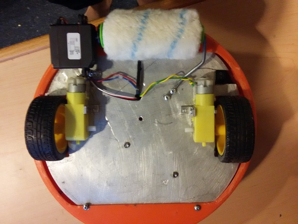

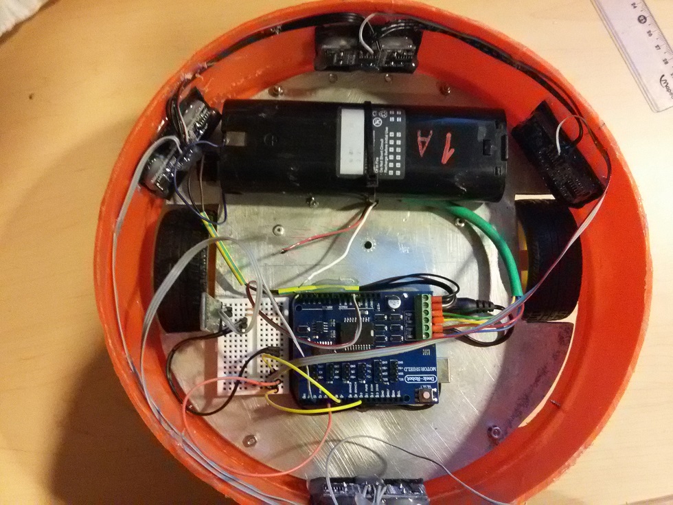

I have built Roomba style cleaning robot. First let me describe my bot and then I will ask for some assistance :slight_smile: To tell the truth, I started this project to have some fun. But when I start my robot with mop, i realised that he is not for playing - he is mopping the floor quite well!
Hardware:
Aluminium plate (solid base), plastic ring (body) cutted from garbage bin. Controller is Arduino Uno, 2 motors for moving driven by motor-shield R3, 4xHC-SR04 ultrasonic sensors (one pointed front, two 120 degrees left and right, last one pointed aft). Bluetooth module. Recently active mop was added (made of paint roller driven by continuous rotation servo). See pictures for better understanding.

Thanks mate! Thanks for the code! Actually you are right. If I have more time I will finally write my own code. However I'm quite far from C programming; it will take time. Also I think my mistake was an attempt to use common trigger pin for all HC-SR04. I did this in order to spare some pins on my Arduino. Now I will change so every sensor will have individual Trigger and Echo pins.
eto_oleg:
I'm not familiar with the Arduino library used to monitor ultrasound sensors, but I know from using these sensors on other microcontrollers it's possible to share the Echo pins and just use individual Trigger pins. This could save you a few I/O pins. Another benefit of sharing Echo lines is a single interrupt can be used with all the sensors. Now that I think about, I'd be surprised if the Library didn't make use of shared echo lines.
When using multiple ultrasound sensors, you want to make sure the echos of one sensor have died down before triggering the next sensor. Noise from other ultrasound sensors is a very big problem if these aren't used correctly.

Oh yes, didnt think of that. But it may so happen that pulse from 1 sensor reaches rx of the other, this would change distance measured, right?
