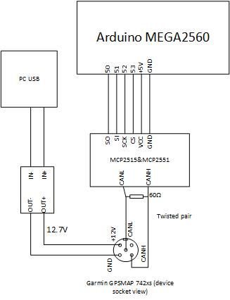

Hi guys so I finally got a Mega 2560 and a MCP2515 & MCP2551 combo board. I cannot seem to get it to work with my Garmin GPSMAP742xs. I tried temperature monitor and looking in the NMEA2000 device list on GPSMAP unit. I also tried Actisense and don't pick up anything.
I have the libraries set up as per the instructions on Github. I do have both the MCP and Due libraries but I don't think that will make a difference. I then also add the line #define USE_MCP_CAN_CLOCK_SET 8 because my MCP board has a 8mhz crystal.
I am adding a rough connection diagram of how I got it wired.
Any help appreciated.

Anyone have some advice for me? I used the MCP2515_Can library to determine that the device initializes correctly over the SPI bus.
There is not much to do. TemperatureMonitor example has been working with Mega. You could also wire int pin and add
#define N2k_CAN_INT_PIN xx
#define MCP_CAN_RX_BUFFER_SIZE 20
#include <NMEA2000_CAN.h>
But I am afraid that it does not help. You need to check wires, powering the bus, terminal resistor connection etc.
Loading different libraries does not make difference. #include <NMEA2000_CAN.h> selects necessary library according to selected processor. So you can have both NMEA2000_mch and _due loaded at same time.

If you get 'send failed' most likely you bus is not working. Either tranceiver is broken or misconnected, bus CAN L/H is misconnected or terminal resistor is missing.

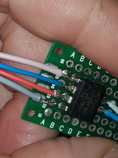

Hi guys, this has by far been the most challenging arduino I ever had but I really want it to work.
I did more tests and had some progress. On all these test I made sure my bus resistance is 60ohms and I had messagesender on one board and actisense listener on the other board.
  1. I connected the two Megas to each other via the two MCP2515 boards. I noticed that when I load message sender on one and actisense listener on the other if work ONLY one way around. If I swop the two MCP2515 boards around if does NOT work anymore. When I swop back it works.
  2. While these two are in a working state (receiving messages on actisense listener) I then connect my Garmin 742xs (without termination resistor to the bus). The moment the Garmin device finishes booting the actisense listener no longer receives the messages from the other Mega. When I unplug the +12V from the garmin NMEA2000 connector it works again. So it looks like Garmin unit prevents the bus from working.
  3. I then take a Due wired in exactly the same config as on Timos Git except I use MCP2551 and a voltage divider on the RX to Mega for 3.3V comp. The moment I connect the Due CAN to the but it also stop working.
  4. I then put a termination resistor on the Garmin unit and connect it to each of the Megas individually after uploading message sender to both. Nothing in the device list. Upload temperature monitor to both and try again individually. Nothing.
I REALLY want to get this to work.
Update: The Due with MCP2551 works with the Garmin GPSMAP 742xs. I suspect that there is something wrong with these CAN modules. Or likely it is because they are running at 8MHz instead of 16MHz.
MCP2515 controller has been tested by some others with 8MHz and it should work.
In some pictures you had only modules with megas connected together. Did you had terminal resistor on that test? Modules has jumpers for enabling terminal resistor and at least on picture 20200424_131150 they were not enabled. In that case it may work or may not.
If you are sure and terminal resistors in case 1 then sounds like other module can not send anything. You could connect the module, which worked as actisense listener to bus with Garmin and Due. Then you should see data.
Hi Timo, sorry I did not mention the detail. Yes those had 120ohm resistors enabled by a solder short on the bottom of the board.
Ok I will try this test and see.
At least the Due now works with Garmin. :). Thx again for the library and all the help.
