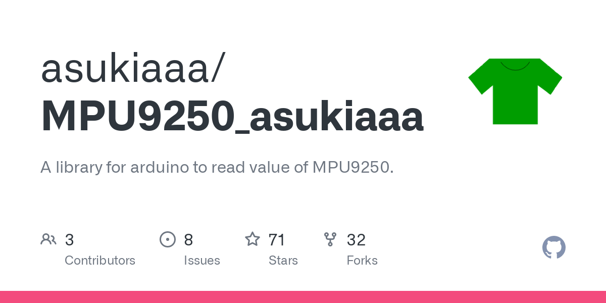

I use this library

Have you seen this issue: Magnetometer reading error · Issue #22 · asukiaaa/MPU9250_asukiaaa · GitHub
The library might not work with the magnetometer.
I think you have to try an other library.

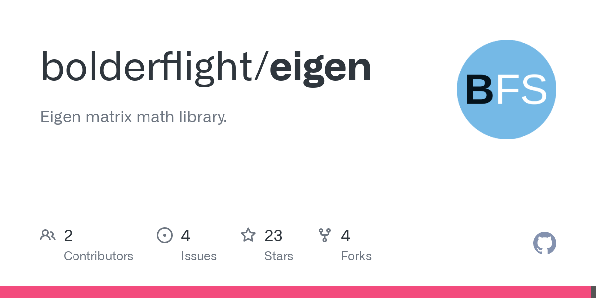

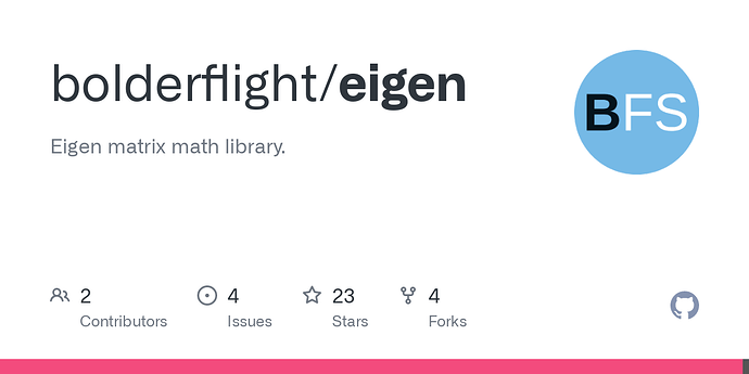

I try install lib from link @ Koepel
But I get this message. And I don't know where to get the eigen.h, I can't find it.
C:\Users\backu\OneDrive\Dokumenty\Arduino\sketch_dec26a\mpu9250.h:38:10: fatal error: eigen.h: No such file or directory
   38 | #include "eigen.h"  // NOLINT
compilation terminated.
exit status 1
It seems to me that the ethos will work on Stm32F4, although it says that this is the only lib that works correctly with GY-91

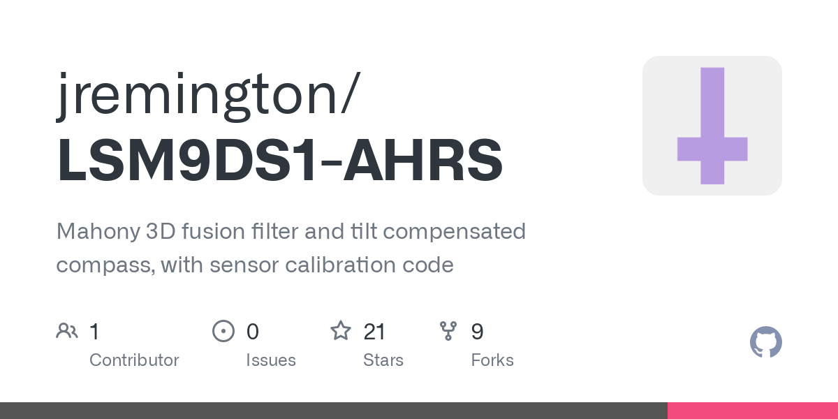

A good option is the LSM sensors :smiley:
Calibrate the sensor, and maybe use AHRS.

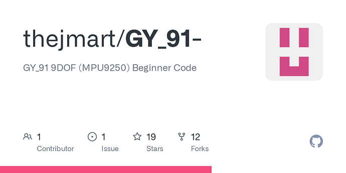

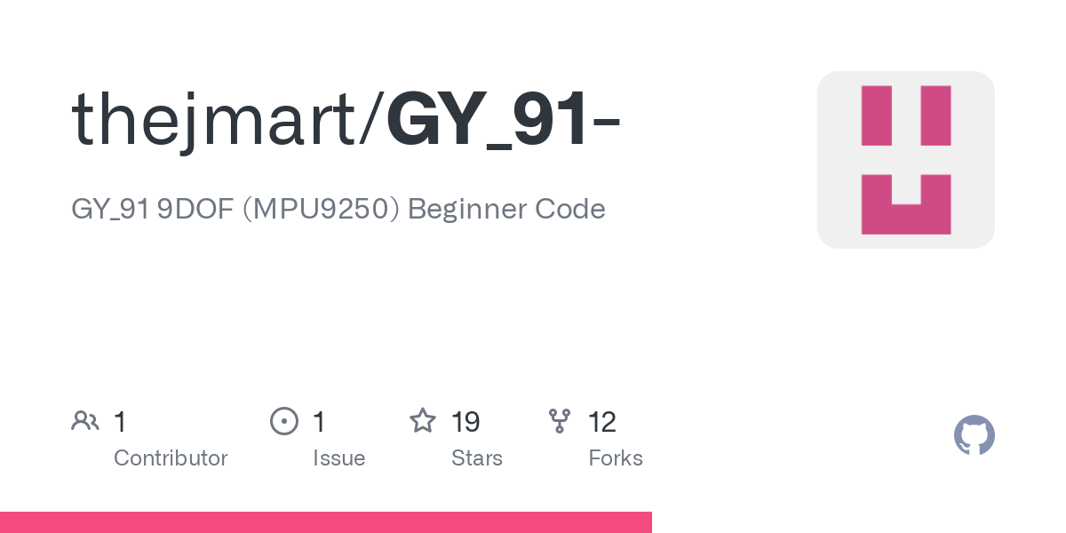

I am trying to use this library now thejmart but I get an error like this:
GY_91_Example_Code:56:27: error: 'MPU9250_ADDRESS' was not declared in this scope; did you mean 'MPU9250_ADDRESS_AD1'?
   56 |   byte c = myIMU.readByte(MPU9250_ADDRESS, WHO_AM_I_MPU9250);
      |                           MPU9250_ADDRESS_AD1
C:\Users\backu\Downloads\GY_91--master(1)\GY_91--master\GY_91_Example_Code\GY_91_Example_Code.ino: In function 'void loop()':
GY_91_Example_Code:169:22: error: 'MPU9250_ADDRESS' was not declared in this scope; did you mean 'MPU9250_ADDRESS_AD1'?
  169 |   if (myIMU.readByte(MPU9250_ADDRESS, INT_STATUS) & 0x01)
      |                      MPU9250_ADDRESS_AD1
exit status 1
