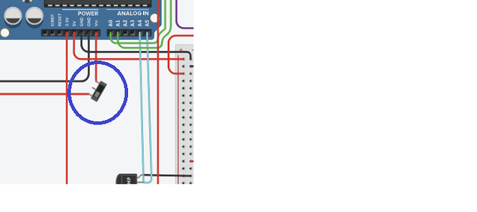

And this is a picture of the system:
(the 3 sensors are supposed to represent the fans, and the solar panel the heating pad. a4 and a5 are going to scl and sda on the temperature sensor too)

What is the "thing" in series with Vin....?
Heaps of other questionable connections also.
Suggest you start again.

You have a sensor connected to pin 1 which is also used for the USB and will stop the serial monitor working .
That’s in your diagram , but not the code !
You have what looks like a potentiometer in series with Vin , that should stop things working too !
I would pull all the wires out !
Then see if you can write to the serial monitor z, then see if you can toggle the outputs - that way you can see any error immediately .
If you have sensors , try a library example first .
Then build your project up
Looks like a power switch to me, when I zoom in on it.
Could be anything I guess ! I went with pot as no handle , assumed it was a trimmer pot … we may never know !
Should I just switch the A1 wire to A2?
Yeah that is a switch to turn the circuit on/off
Im basing this project off of this on > Controlling Heating Pads with Arduino Uno | Astronomers Anonymous < so if this helps.
No ! I’m talking about the wire on the Tx pin .

Then it appears you've connected to the two switched terminals of the switch. Move one of the wires to the center (COM) terminal and try that.
Almost every one I've ever seen is wired thusly:
