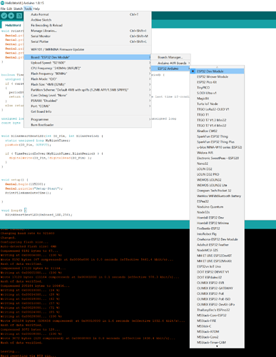

I tried several board types but none of them works still have the same issue. Now I am on the dev module:
Some links mention a power-problem. Not sure if this is the case as you can upload the code.
But you could give it a try to use another USB-cable.

yes, I already played with the USB cable. Some basically not work at all, I cannot even upload the code runs into "MD5 of file does not match data in flash!" error. I have long and short one that works, at least I can upload the code.
But, I was trying I think hundred time to upload the code and check in the serial monitor. Never worked but ONE time not long before. After I uploaded I realized the led is blinking in blue. And the serial monitor also shows the hello world. See attached
After this I tried to upload the code again and not works any more. Again tried hundred times. Pushing the reset button then EN and whatever combination. I was wondering I might pushed the buttons in a combiantion that I have not before. But not works....I am really fed up.

Installed the IDE on a brand new PC. Only set the board manager URL and installed the ESP32 board manager, just USB hooked up with Hellow World scetch and the problem is the same.
BEside the yesterday messages I also get some new one:
rst:0x10 (RTCWDT_RTC_RESET),boot:0x13 (SPI_FAST_FLASH_BOOT)
flash read err, 1000
ets_main.c 371
ets Jun 8 2016 00:22:57
I have to order a new one or will go with my good R3 with ESP01. Thanks!
Looks like the flash-memory has a problem.

FYI, I have received a brand new NodeMCU, the same type as the previous one and works perfectly. So, the prevous ESP32 was faulty that is why it did not work.
Thanks for your support!
