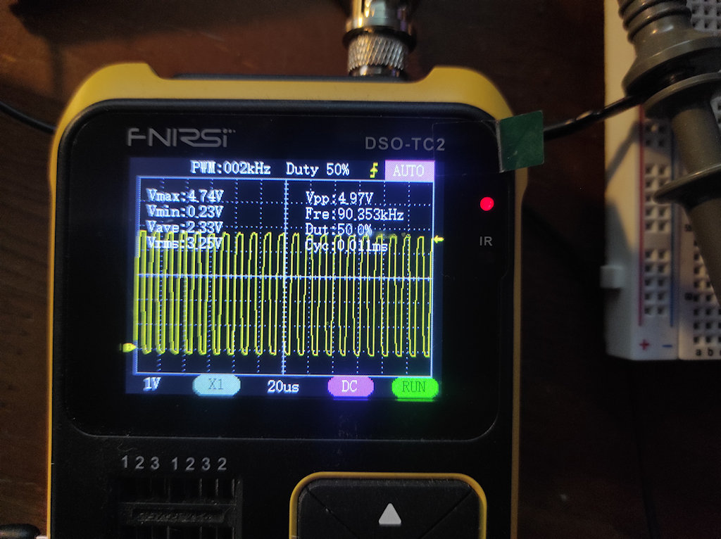

Trying to play some WAV files from an SD card in Arduino Nano, but I have noise at the output, but only after the low pass filter. This was unespected, and could not find a solution to this.
Removing the 10nF capacitor I get the PWM frequency, but no audible noise. With the 10nF the PWM freq. gets low, but I get lots of noise.

I've made e video of this: Video removing the cap

You 'scope is showing 90kHz and I assume that's the PWM frequency.
Of course, that's not what you're hearing.
Yeah... I think without the filter you are saturating the amplifier at 90kHz and it's putting-out a square (or rectangle) wave that you can't hear, while killing anything else that you might hear.
Something similar would happen if you saturated it with DC, "slamming" the output at the maximum DC voltage (or at 0V) so that no signal could get through.

I feel so stupid... The noise is coming from the PC through the USB. I connected it to the power supply and disconnect from the PC and it's gone.
