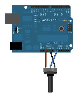

None of the Analog Read Examples are working with 2560
I tried all the examples (the basic examples ) using analog input with potentiometer, even changed to a resistor but none of them worked, the serial monitor always show 1023, and in other examples using leds, the potentiometer doesn't change led brightness. Sorry for my bad english.

Following this image: Using 110k potentiometer. But the serial always showed 1023, even using the potentiometer at the mimimum.

Well the picture doesn't tell us if you correctly identified the pot's wiper terminal to wire to the analog input pin. You should take a multimeter voltage reading from ground to the input pin to see if the voltage does change from 0 to +5vdc as you move the pot's know through its range. Also 110K ohm pot is awful large value, analog input pins work best with 10k ohm or less of source impedance.

I correctly identified the pot's outputs, because i tested it on the arduino uno today , and it worked perfectly, the same code, all works fine with uno but not with this mega 2560.
Your Fritzing diagram. (I hate 'em) doesn't appear to me to show a Mega.

While the pot was connected(it was connected right) to the arduino , i used a meter to measure the voltage in the pot, while i changed the resistance value, but the output of the pot was at 5 v all the time...
And when you disconnected the wiper from the input, and measured the voltage on the wiper..? And when you tried a different input..?
Sounds like the ground end of the pot isn't connected correctly to arduino ground, or bad wire connection, bad pot terminal, or something of that manner. If you measure only +5vdc on the pin then your software will only read values of 1023.

The pot is fine , i tested it on UNO, works perfectly. I connected the Pot terminals even at solder in the back of the board. NONE of the analog ports is working,but the DIGITAL are okay.

Well you are going to have to figure out why you only measure +5vdc at the pot's wiper pin output wired to the analog input pin, even when you turn the knob through it's range. The fact that you only see +5vdc applied to the analog input pin needs to be fixed before you can expect the 2560 board to read the pots value.

Did you try running the A0 pin straight to ground? Just to see if the Mega will report back 0? If that works take the wire out of A0 completely and see what the results are. 'Normally' you get fluctuating values. If it comes back as 1023 there is a problem.

I already did it, but it only shows 1023...
Even grounded? Sounds like a short somewhere, but if you ground it, I'd expect that to short the supply. Can you post your actual code, not the stuff you posted in reply #2.

So you are saying that even running a wire from A0 to ground you are getting 1023? Are you connecting a wire from A0 to the GND port on the Mega directly?
If so something is wrong. Even if there is a short running it directly to ground should bring it down. Is your Mega sitting on top of a metal table or something? There are no shields installed right?
