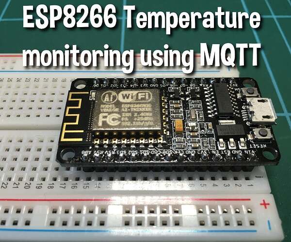

I however am not been able to combine these to send temperature readings to my MQTT server,
I can fine alot of examples for this but they are all for other sensors (DHT11 or BME280)
Like these examples ;
So it looks defenatly possible to use the enc28j60 to use pubsub (also confirmed by pubsub maintainer that it should work with the new UIPethernet.h
but for the life of my I can not find a way or an example to send the temperature data from my DS18B20 to a MQTT broker, I do find examples like these :
but they all work with Wifi modules and not an ethernet shield and my very limited knowlidge makes it impossible to convert them to my ethernet shield :frowning:
If anyone could point me in the right direction or knows of a project/example with the ENC28J60-DS18B20-MQTT combo that would be awesome.
