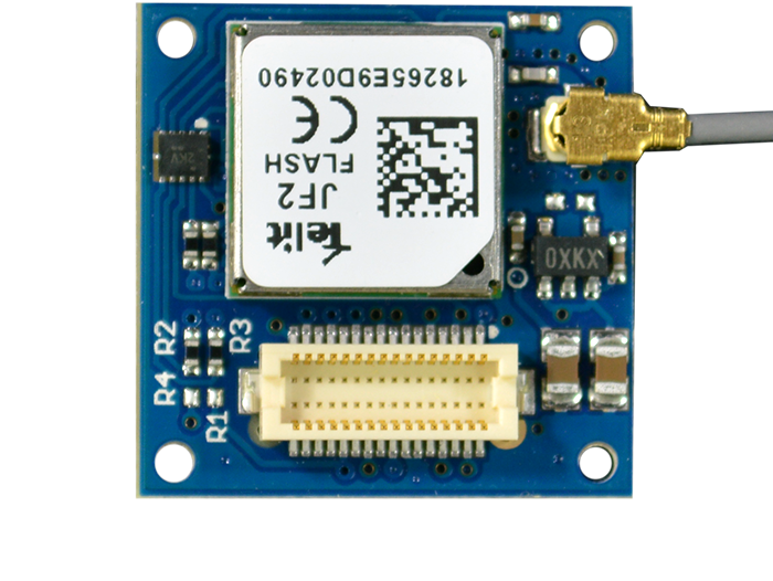

I have a TinyScreen+ (Arduino Zero) and GPS TinyShield (Telit JF2 GPS)
I am trying to get the GPS to print ANYTHING to the serial monitor.
I'm using SerialUSB for printing and I am seeing all my debug statements come in.
I'm using Serial1 to talk to the GPS, and I am able to change from hibernate to active state and check that it worked.
However I am not receiving any data from the GPS. I read that the GPS can't position itself if you're indoors, which I am. However, shouldn't I at least receive empty messages every second? I am literally not receiving a byte. (I am going to try this outdoors tomorrow but just wanted to post and see if that is the problem).
For detecting bytes, I am literally just looping on available()
while (Serial1().available() <= 0);
But it never exits that loop.
I tried it with both baud rates 4800 and 9600
While that device calls itself a shield, it does not appear to be what the Arduino calls a shield, in that it doesn't appear to plug into the Arduino.
So, how IS it connected to the Arduino?

The TinyCircuit components all have this bar for the pins where you can stack components and all he pins line up vertically.
It's stacked like this: https://tinycircuits.com/blogs/learn/tinyduino-gps-tracker-data-logger-tutorial
However my arduino zero chip is larger so they're not the same size as in the photo

The pin info on the GPS shield is:
A0 - GPS_RX:  Software UART Transmit from the TinyDuino to the GPS Module.
A1 - GPS_TX:  Software UART Receive to the TinyDuino from the GPS Module.
A2 - SYS_ON:  This signal is an output the GPS module to indicate if the module is in an active mode (the signal is a logic-high) or in hibernate mode (the signal is a logic-low). By Default this signal is connected between the GPS module and the A2 signal using R7, which is a 0 ohm resistor. This resistor can be removed if this signal is not needed to free up A2 for other uses.
A3 - ON_OFF: This signal is an input into the GPS module, and is used to transition between hibernate and active modes. Transitions between states are made with a low to high pulse on this signal (minimum time of 100uS).
0 Rx and 1 Tx maps to the hardware serial for Serial1 (0 Rx and 1 Tx) so it should be connected.
Wait... IS THAT THE PROBLEM? I'm connecting receiver to receiver? :frowning: But because of the way the tiny circuits boards are I can't actually redirect pins physically.
And because I'm using Arduino Zero, I can't use the SoftwareSerial library...
Am I screwed?
Another question, why is the Rx and Tx pins on the GPS emphasized as "software UART"? Is that different from "hardware UART" if that's a thing?

Is a "shield" separate from the GPS itself? The GPS's 4 pins is connected to the Arduino via the bar of pins when stacking it.
My Arduino is a TinyCircuit and the only GPS TinyCircuit is the GPS TinyShield, so I would have to get those 2 components working. I need to keep this small because my cat will be wearing it.
I solved my issue by using the SoftwareSerial version that works with Arduino M0 PRO in Arduino Zero - SoftwareSerial library - Arduino Zero - Arduino Forum
With it I was able to create a serial to the A0 and A1 pins that the GPS uses. Now I'm getting data!
