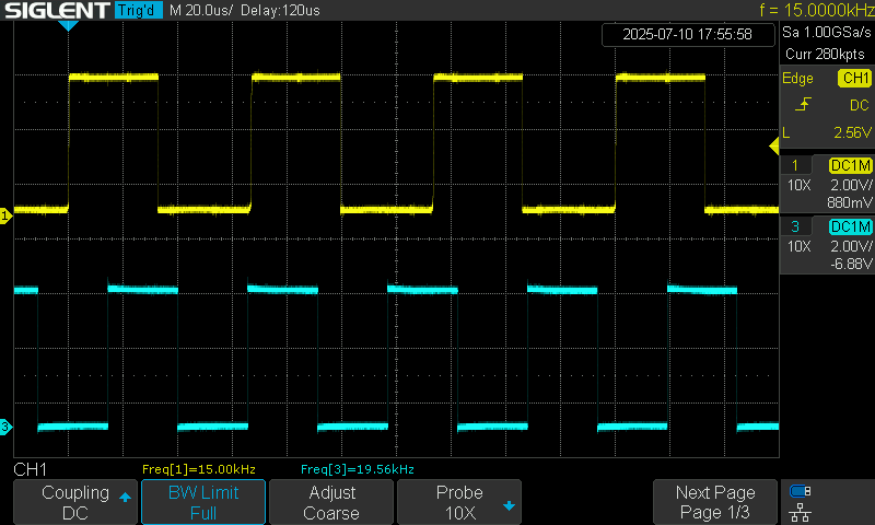

Here are some oscilloscope traces showing the operation:
  • Channel 1 - yellow trace - input frequency on pin 2.
  • Channel 3 - blue trace - output frequency from pin 19.
Here is a 15kHz input multiplied by 1.33 to give 20kHz.
And a 500Hz input multiplied by 0.6 to give 300Hz.
There is a lower limit of around 250Hz to the frequency that can be generated (period = 4.096ms).
Frequency error is greatest at higher frequencies as the period of the incoming 15kHz input (66.66µs) is measured in multiples of 4µs.
I've tested the code with the scaling factor between 0.1 and 10.

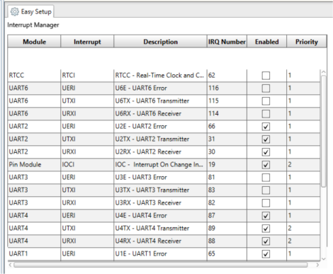

some processors, e.g. PIC24FJ1024GA610, have a priority based system where more critical high priority interrupts can interrupt lower priority ISRs
e.g. using the MPLAB Code Configurator to set interrupt priority level
