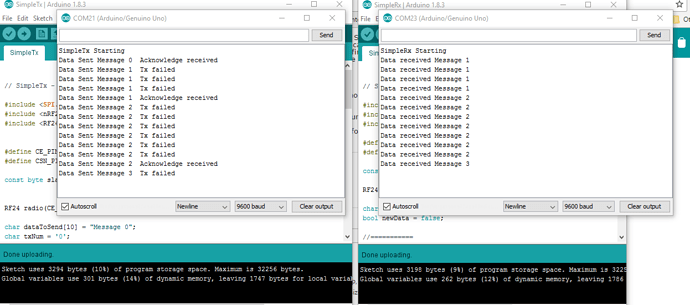

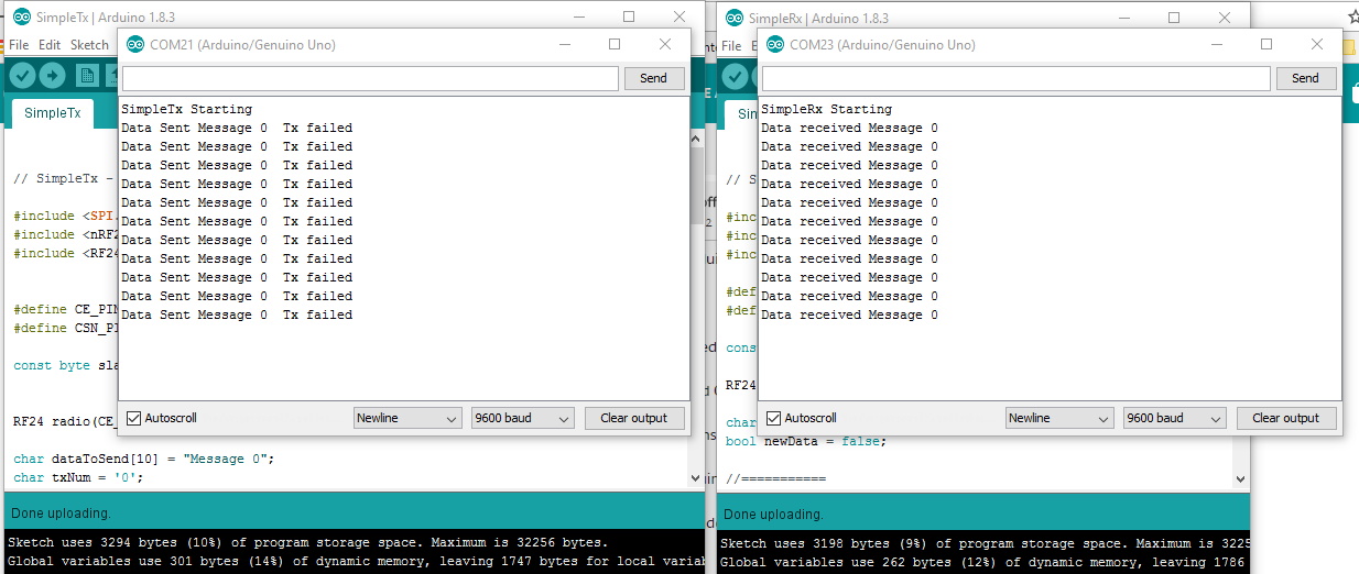

What does the other Arduino show?
The Tx Arduino serial monitor was outputting 'Data Sent Message 0 Tx failed'. I have attached a photo displaying both serial monitors side by side so you can see for yourself. However, I found that some times I re-upload the programs I will get some confirmation of data received but it's not reliable as then some of the next transmissions will fail. I have attached a photo of the serial monitors showing this behavior as well.

Images from Reply #8 so we don't have to download them. See this Image Guide
...R
As you can see those pictures are unreadable. Please just copy and paste the output as text.
I can not get it by copy/paste from the serial monitor, which is why I took the screenshot sorry, but you can see them if you download the images.
Very strange. I just copied the following from my SerialMonitor
SimSimpleRxAckPayload Starting
