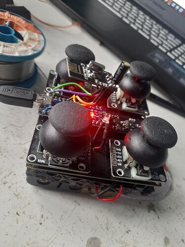

NRF24L01 SPI not connected, transmitter
Hello,
i have a transmitter with a couple of joysticks, the wiring is correct on that one because i used it before and that works.

this is wired to arduino nano (old bootloader).
when i move the joysticks i get serial data so that should declare that transmitting works.
but at my receiving end, wired to an ESP32 S3, i dont get any serial data:

i have the NRF24L01 wired to the 3.3V and GND of my ESP with a 10μF capacitor in parralel, also on my transmittr but then my nano

but i will charge my 3s Li-ion powering it. because it has been lying untouched for atleast 1.5 years, so that could aslo be an issue. but i didn't think of that because my nano does turn on.
Battery is at 84% so that is not the issue

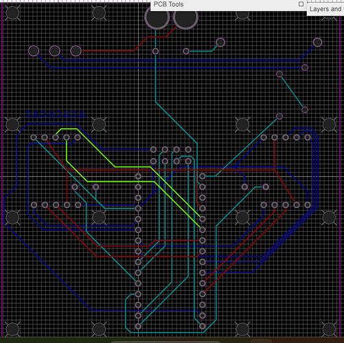

Since it apparently worked before, I suspect a hardware problem. Could you post an annotated schematic showing exactly how this is wired? Be sure to include all connections, power, ground, power sources, and note any wires over 25 cm (10 inches) in length.

i double checked the wiring for my transmitter, this is a PCB so that is correct.
4 joysticks, 1 nano, 2 leds and 1 NRF24l0 module. but this worked before. but i just uploaded it to show you guys.

switched it out for a 6 series AA +- 9V same result: NOT connected
nano 3.3V pins gives 3.34V
edit 2:
just wired all the connections going to my NRF24l01 parralel to the ones running in the PCB, still the same result: NOT Connected
This type of problem is not usually a power supply issue, but a wiring issue.
If radio.begin() is failing, the MCU and NRF24 are not talking correctly over SPI, so its an SPI issue.
Either your CSN pin is misconfigured, wiring is incorrect, or you have a bad connection/short somewhere in your PCB.
I checked my wiring multible times, it is correct, also in the code. looking at my PCB in EasyEDA, i dont see any shorts (and remeber it used to work just fine, but after touching it it doesnt work). and also with extern wiring from arduino to NRF it still doesnt work.

i think what i am going to do, is cut thorugh the 3.3V and GND of the NRF in the PCB and wire a working NRF directly to the arduino itself.
i may look ugly but aleast it will work for now. this is a project for school and i need to get i working asap

Sorry I do not have the time to trace your PCB wiring without a schematic, how would I know what is what?

nano photo
ESP32S3 photo
A separate power supply for the radios is the best solution.
i see that now, back then i didn't have that knowledge. but after working on this again i noticed multiple things that can be improved, when the time (and money) comes that i will need this again i will design a good, high quality transmitter suitable for many project, with suffiecient power for all systems.
but right now this is what i have to work with because it is for school and i dont have the time to upgrade.
this is how i have it right now:
on the right you can still see my old NRF24L01 with antenna removed (because i don't need that anymore)
and i got the message Transmitter is connected
