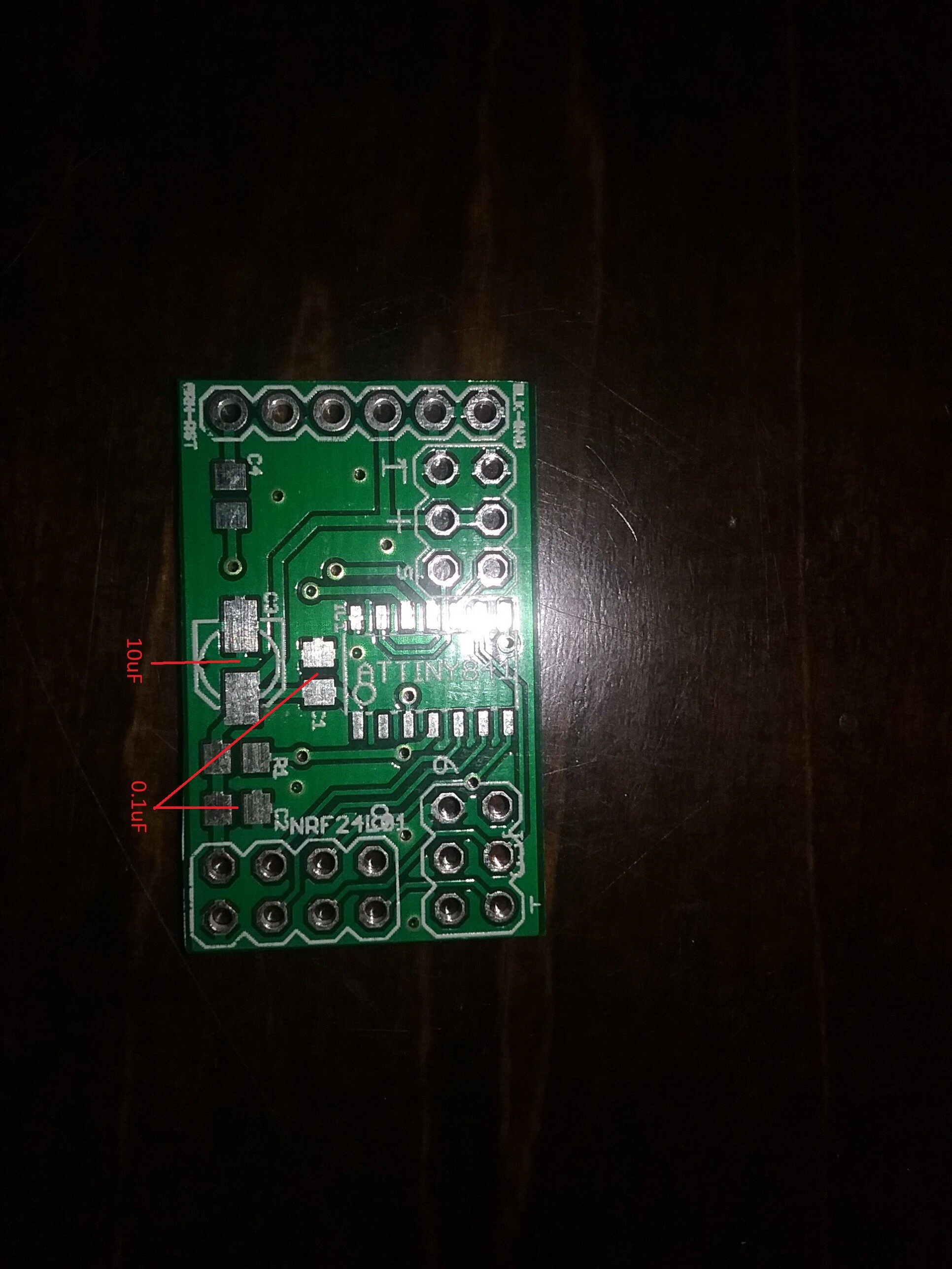

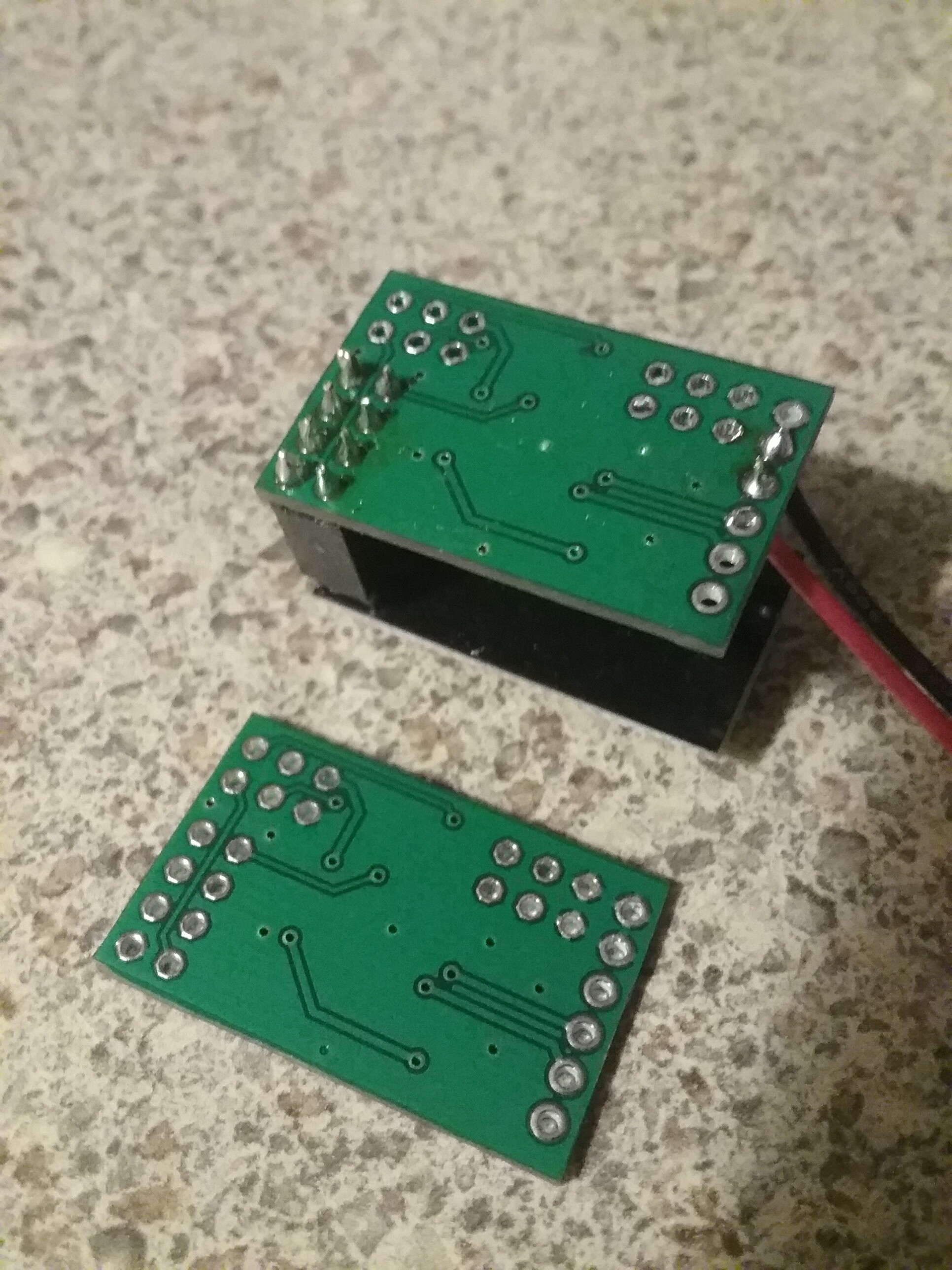

Pictures of my board are attached.
Any help would be appreciated.
Other picture.

Image from Original Post so we don't have to download it. See this Simple Image Guide
And from Reply #1
...R
I'm not sure what the images are intended to show. A schematic would be a lot more informative,
I don't see any sign of a 10µF capacitor across Vcc and GND for the nRF24, nor is it clear how the whole thing is being powered. A pair of AA alkaline cells (3v) should work fine.

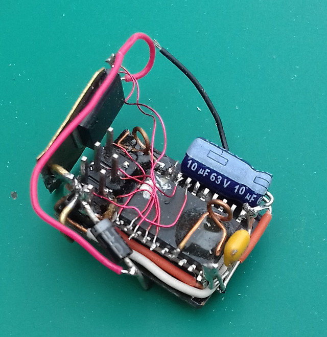

This is my Attiny1634 attached to an nRF24 - with the PCB antenna sawed off the nRF24 and relaced with a short piece of wire. (Small size was the critical factor).
...R
