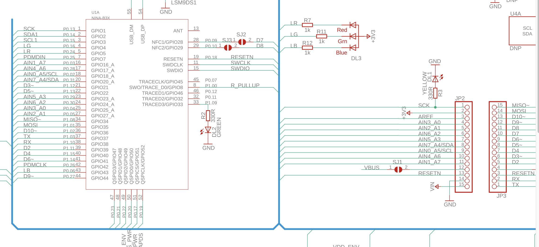

Numbering of Port Pins /LED/ is not clear to me
I am using Nano 33 BLE Sense and tried the rgb example.
But the green LED is not working.
I have define Ports as follows:
 #define RED 22
 #define BLUE 24
 #define GREEN 23
 #define LED_PWR 25
But If i look into the schematics.
https://content.arduino.cc/assets/NANO33BLE_V2.0_sch.pdf
I can see that the led are connected to this ports.
LED_BUILTIN  port 13
LED GREEN 16
LED RED 24
LED BLUE 6
Why is this discrepancy.... br joachim
Does the unmodified example code you linked not work? If not, perhaps the green LED is defective.
You appear to be confusing the port bit designations with the Arduino pin IDs.
For example, in the schematic, the green LED (designation LG) is connected to bit 16 of Port 0 (P0), also called GPIO4, which is mapped to some Arduino pin number in the boards file.

but only the power led and the red led are blinking. br joachim

if i run that only the power led is on at the end.
if I turn on only one led respectively, only the pwr_led will turn on
if i turn on the red led, no led will turn on
if i turn on the green led, the blue led will turn on
if i turn on the red led the blue led will turn on.
rather strange...
I think as well the board is defective.

Sorry, I have no idea what is going on. The schematic could be wrong (it shows a common anode RGB LED, with the anode connected to 3.3V), or the pin designations are wrong, or some parts or connections are defective.

Hmm. I'm not finding a lot of actual info on the "BLE Sense" - the links on the product page for schematic and EAGLE files both end up linking to files for the "Nano BLE" (without the sensors.)
And I don't see a separate board type, variant (where arduino pin numbers are mapped to chip pins), or any examples for the BLE Sense. I suppose it could be exactly a Nano BLE with all of the sensors connected to the I2C bus, but there's no way to tell. Grr.
(Looking at the photos, it seems that the NanoBLE board is the same as the BLE Sense, but with the sensors not populated?)
Note that the variants files already define "LEDR", "LEDG", and "LEDB"
i have tried this as well
analogWrite(LEDR, 72);  //GREEN
analogWrite(LEDG, 122); //BLUE
analogWrite(LEDB, 234); //RED
but only the red led turns on
This does point to a defective board. But the documentation is atrocious.

Now I have got two new boards (without sense devices) and led are working as expected.
