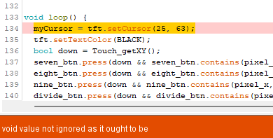

Numbers not printing sequentially
This is some code for a calculator (I haven't got code for the actual calculations yet), but every time I press one of the buttons, it prints it overtop of the last number. In other words, it isn't printing the numbers sequentially. Where is the code messed up?
It looks like the first line in the void loop is what is messing it up, but I don't know how to tell it to only set the cursor for the FIRST number.

If you know how to fix this, please enlighten me!
To confirm what you mean... if you press 4 then 2 say, it prints a 4, then replaces that with 2 to display only the 2, rather than displaying 42?
edit- if so, and yes that could be due to the setCursor() at the top of loop(), you could have a variable say "myCursorPos" which you increment each time you press a digit, and then use that variable in the setCursor().
@proton_aligner
No, it prints a unintelligible symbol, it does not erase the 4, but prints the 2 ON TOP OF the 4, while still displaying the four, displaying a 4 and a 2 on the same spot.
And what do you want it to do?- print 42 in two contiguouscells, or replace the 4 with the 2 to display a "nice" 2?
@proton_aligner
I want to print 42 in two contiguous cells.
Then try my idea of incrementing the position in the code.
(Disclaimer- I've never tried to use one of those screens)
@proton_aligner
That would be extremely complicated, but I'll try that if @david_prentice @6v6gt don't have any usable ideas.
What is a code example of doing that?
Why don't you try to implement it with the clues I gave in #2 ?

You can't just make up syntax like
I was thinking something along the lines of...
  • create a variable byte myCursor= 25 (or whichever of the 25 and 63 is the right one)
  • then where the digit is pressed do a myCursor++
  • and then setCursor(myCursor, 63) before doing the print.
@proton_aligner
myCursor = 25;
  tft.setCursor(myCursor, 63);
  tft.setTextColor(BLACK);

This works. Until I want to start with a number other than 7...
