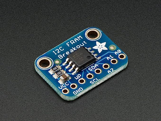

The OP might consider using FRAM that has quite a bit more read write cycles then the NVRAM on the RTC modules.
