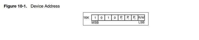

True but the datasheet also states:
The A2, A1 and A0 pins are device address
inputs that are hard wired or left not connected for hardware compatibility with
AT24C16.
Then read the AT24C16 datasheet
OK, that part doesn't have address pins. They are labeled NC which means don't use them.
I've missed any point you were trying to make.
