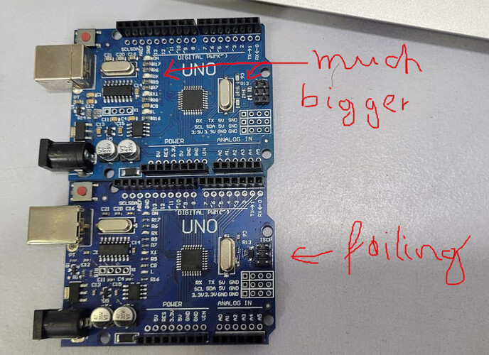

Hi there,
I have two identical Arduino boards, but they have an inconsistent behavior. I wrote a sketch that I uploaded to both arduinos, and one of them unexpectedly resets every 10 seconds or so. The other one works fine.
I did the usual trouble shooting for reseting arduinos (I checked the power supply, the value of the pulldown resistors, I ran the program disconnecting everything except the usb port from the board)
I also tested with a very simple sketch. In this case, both arduinos work as expected.

I noticed that modifying the delay at line 234 modifies the time between resets (the longer the delay, the longer the time between resets)
What I want : I need the arduino to keep working without resetting. What could cause those resets ? I tend to blame my code and not the external electronic.

Use the debugging technique of swapping the boards with the code. If the failure follows the code, then the code is likely at fault, if the failure is always the same board regardless of code then it's the board.
it is on the board. I tested both boards with both codes, only one board fails. From that point, what can I do ? there are several places in my code where I save the result of millis() in a variable, is it possible that I fill up the memory without ever freeing it, so a board crashes every time it memory get full ? As I'm not very skilled in C++, I don't know what to do next for debugging.
So you now know that one board only has the problem. Is that a clone board? If it is get a genuine Arduino board. If it is a genuine Arduino board, then it sounds like you damaged it somehow. What Arduino board is it? If it is one of the few 3.3V boards and you inadvertently applied 5V the board is likely damaged.

@sonofcy Both are clone board (btw, was I supposed to post in another forum ?) . Now that I look at them much closer, I notice that the passive components are not the same packages. The failing board has smaller components. Can it be the explanation ?

maybe so, but as I just bought it few days ago, I was surprised it was already broken.

Depends entirely of the source, is it AliExpress or similar, price is like $1, what do you expect.

The board costed me around 14us$ (half the price of an official one). But yes, I'll buy an official one and check. If it works I'll conclude that there's nothing to salvage about the one I have.

If you're into electronics or someone you know, it can be a fun project to fix. A couple of components that are suspects: the voltage regulator, and the MCU. First is not that difficult to change, the MCU much more.

From what you've described, the board appears to be faulty. Have you tried uploading and running other sketches on it? If those also fail, it's likely time to discard the board. If they do work, make a note not to fully trust it—intermittent or unpredictable failures may still occur.
I've seen components become damaged just from being handled. While modern parts are generally more robust, exposure to conditions outside their specified range can still cause harm. Once damaged, a component can fail in countless unpredictable ways. It may not fail immediately, but failure is inevitable—we just can't predict exactly when it will happen.
