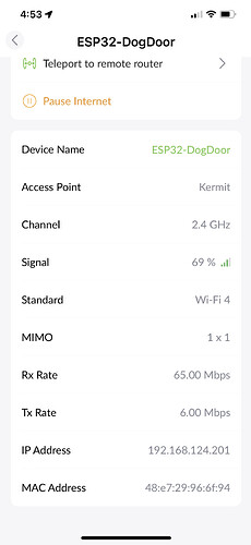

And now I can see that it's connected to my kitchen node at 2.4 Ghz

By the way this is what my router shows when the one ESP is connected...

I still had all kinds of trouble connecting. To where even the one that sort of worked stopped working. All the while the "bad" ESP board would connect instantly.
I fixed it now though. Now all the ESPs connect right away.
The fix was an option on the router called "Router Steering". It says that directs devices to the router instead of the mesh points. So this fixed it for me.
My network is a mesh with a main router and two mesh points. The ESPs were often connecting to the main point before as well, as it is the closest and has the best signal.
