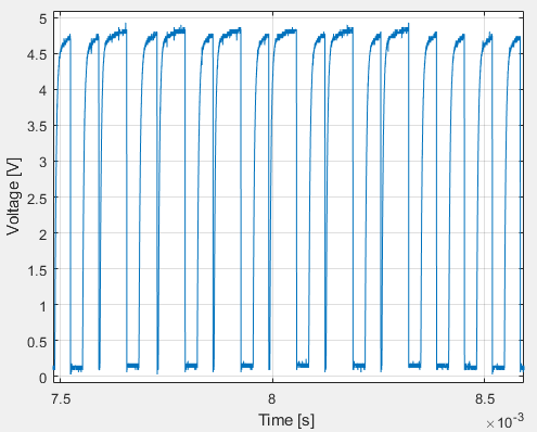

One wire DS18B20 reading +85°C, then -127°C and Arduino hanging up completely

I do not use any pull-down ( = to gnd !) resistor for the 1-wire bus.
Anyway, thanks guys for your inputs about the hardware, BUT: Could anyone PLEASE go through my software code? Here I would need your support. Is the code, as I have programmed it with the help of all the pre-defined libraries, according to the datasheets? Why is the uC sometimes then hanging up completely at all? I thought I will use Arduino, because I really do not want to bother with buffer overruns and pointers out of scope and similar stupid errors! These should handle the Arduino or the pre-defined libaries I have downloaded in, I hope, not version v1.0. I only want to write a code line, e.g. "sensor_bus.requestTemperatures();" and it should read the temperatures and that's it! But for the SW, the problems are starting for me: One guy says: Add "delay(1000); ", another guy says: "No!" (see e.g. "Why does this fix work for DS18B20 error code 85"). For a hardware problem I would know exactly what to do, but here in SW, I only of course tried also here just a lot of combinations to add on different places a delay here or there or add "request temps." after a "begin", as it also was proposed in the Arduino forum help, and so on, but nothing helped for me. What did help, it seems up to now, against the -127°C and +85°C error was unplug and re-plug the 3 pin 1-wire connector to all the 7 sensors. But 1st: It's illogical to me, why then just one sensor had this problem of the 85° and it could be healed with hardware, it seems, and 2nd: I think, all this has nothing to do with that the Arduino hangs up after days or e.g. also 2 weeks. I learned in the past that there is a limit on 58 days or so, but this is significantly more time than some days.

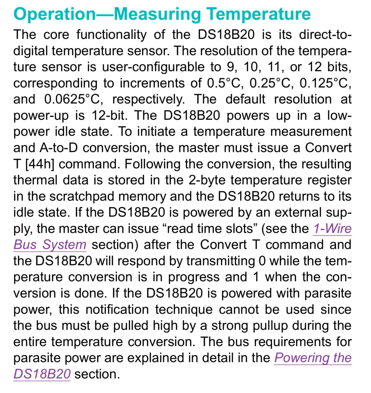

The "85" tells you you have not given the sensor enough time to do its job, and the specific sensor is the first one sensed. Assuming a kosher power supply, a delay(1000); in setup will probably fix it - permanently. The "-127 sometimes" tells you that your peripheral connections are slack-arsed. It could be that your power connections are no better, and your problems are (nearly) all down to bad soldering. There appears to be nothing abnormal about your cable lengths, indeed quite the opposite, so you use a 4.7k pullup like the good book says.
The sensors do their internal processing independently of Arduino. You can have a swag of sensors working in a one second loop. I doubt there is any point in going any faster. Your code, as the picture below will attest, is a verbose insult but, since you do seem to get a result occasionally, there may actually be nothing much wrong with it.

Not quite, but you might say it has enough time now that you have played around with the three pin connector.
To reiterate more clearly, the 85 tells you the sensor has not had time to do its job. This can be either from power-on, or the last time it delivered a reading. Note that "power on" includes restoration of power after involuntary power-off,

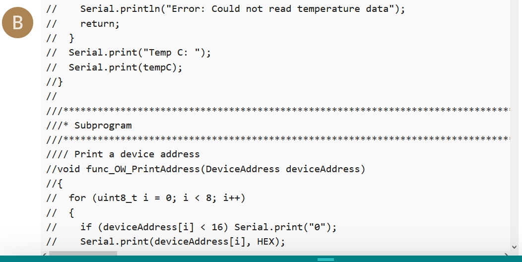

Last thing: About my “rubbish” code. Why??? I mean: Why is most of my code rubbish? The whole thing is operating now 24h a day since “gilshultz” was giving me a very nice hint in post #5, so since 13.1022 now without ANY error so far. I repeat, I am not so good with software, but this fact makes me believe that most of my code cannot be SO rubbish if it seems to work now! But if you say so, that “most of my code is rubbish” then you are cordially invited to correct it, please, that’s what I exactly ask all the time. But “support” for me does not mean, that just anyone says: “That’s all (sorry: “most”) rubbish”. This is no support for me. But rather, to make a precise suggestion what is not good in my code and how to correct. Please, then, at least tell me all the faulty code lines / segments, and how to replace them with a better code, and this for me, as a non-professional software guy, means: In CONCRETE what to write in C so that I can learn and understand. Just saying “that’s rubbish” is worthless for me and maybe also for all the other readers who might have had / will have in the future the same or a similar problem. And, as I said: I do not dare to leave out any code sections to post, because exactly this may then be the cause of the hang-up you professionals see but I am overlooking. This is my thinking.
==> So, therefore: Is there anyone please in this forum who is willing to check my code and maybe spot a point which could lead to a potential hang-up of the Arduino and how to correct it? (It’s working now since 13.10.22 without interruption but I am just waiting for it to happen.) THIS would help me!

As I believe I said in post #23, your problem probably has nothing to do with code and everything to do with bad connections. That said, you post code so that somebody else can read through it, and posting the entire code that shows the problem is prerequisite. That does not mean code that is full of junk, comments, and whitespace. In your case, a 50 -line tutorial would have given the same reult and was just as valid. What you posted was 825 lines long and so obviously full of junk it wasn't worth reading, so did you seriously expect somebody to scroll through all that on the off-chance that something might be wrong with it? I might point out that some people are on this forum with just a phone.....
The following edit is 546 lines long and, if you bother to run it, you might never know the difference! If you can get it down to 413 lines with the same result, it wouldn't surprise me. There is I2C scanner stuff, parasite power, several dozen useless serial.prints, and God only knows what other redundant or irrelevant stuff stashed away in there - all clogging up the forum code-window. As I said, a bloody insult, as the posted picture above shows....

Yesterday it happened, the whole Arduino hang up. So, as I am not so good in coding, is there someone in this forum willing to skim through and check my code what I maybe did wrong, that my program hangs up?
Yesterday, I changed my pull-up from 1k to 4k7, not much of a change. One sensor then again read “+85°C” and I un- and re-plugged the power several times until it wrote a valid temperature. So for me should be (also) a software problem. But where???
Below, 2 screenshots with 4k7 as pull-up, one short, and then a zoom inside of a long pattern:
Pullup4k7_LongPattern_Scope_AnyPartZoomedIn

Yes, I “expect” or much better said, I would be grateful, if someone could look through my entire code and spot the problem. If I get from someone a device, they say: Its not working, And I start to unscrew (which can be challenging) it and check one after other things until I may find the problem and repair it. They do not give me the already disassembled PCB and tell me “here in this region there should be the error”. No! They "throw" me the complete thing. So, if there are some software professionals in this forum, I think they will recognize in a second my commented-out parts of code and will consume much less time, I guess, to just mentally skip reading that commented-out part in contrast to me unscrewing some devices for other people and only then start with the search for the error.
SO PLEASE, GUYS, next days I will drive away for several days, and it WOULD BE VERY BAD, IF THE ARDUINO WOULD HANG UP DURING COMPRESSOR ON of the cooling, so the compressor would run continuously 24h a day, AND EVERYTHING WOULD FREEZE and I could throw away my things there. WHERE COULD BE THE BAD PORTION IN MY CODE WHICH CAUSES THE HANG-UP OF THE ARDUINO? As I already said, with parts of my code it seemed to work, or, better said, at least I didn't recognize a hang up. Maybe just with this "full" code.

Ok, 1k needs more power than 4k7. => And what I shall do with that info?
“Wiring the devices like say ‘here’ ” => Yes, I think I did. I described my setup in post #16. And I think, it’s ok. Or what you want to tell me with your words?

You do the requestTemperatures() and you read the temperatures without time delay. You must gives the sensors the time to compute the temperature. In my code the temperatures frow the request 1.5s before where read.
The DS18B20 has more problems to pull down with 1k then with 4k7. That Maxim in the datasheet and application notes gives 4k7 has a reason. Who knows the sensors better then Maxim? Have you made the same scope image with 1k?
In your code stay
If you use parasite power, most of the time the databus must be high.

@bernd2700 , the datasheet… HERE… Will help a lot.
Page 18;specifically for your problem, and…
Did you notice the conversion takes 750mS at 12 bit resolution…. are you waiting ??
