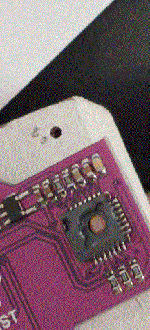

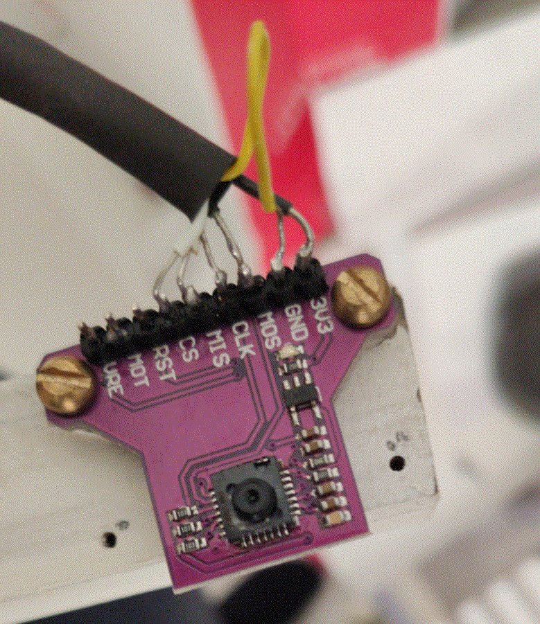

These sensors require a sharp focus to see texture detail, you've moved the lens? Is it in focus?
I just installed the lens on the sensor(there were no istructions whatsoever).
I am attaching two images of the sensor - with and without the lens.
can you explain how i know the sensor is focused?
