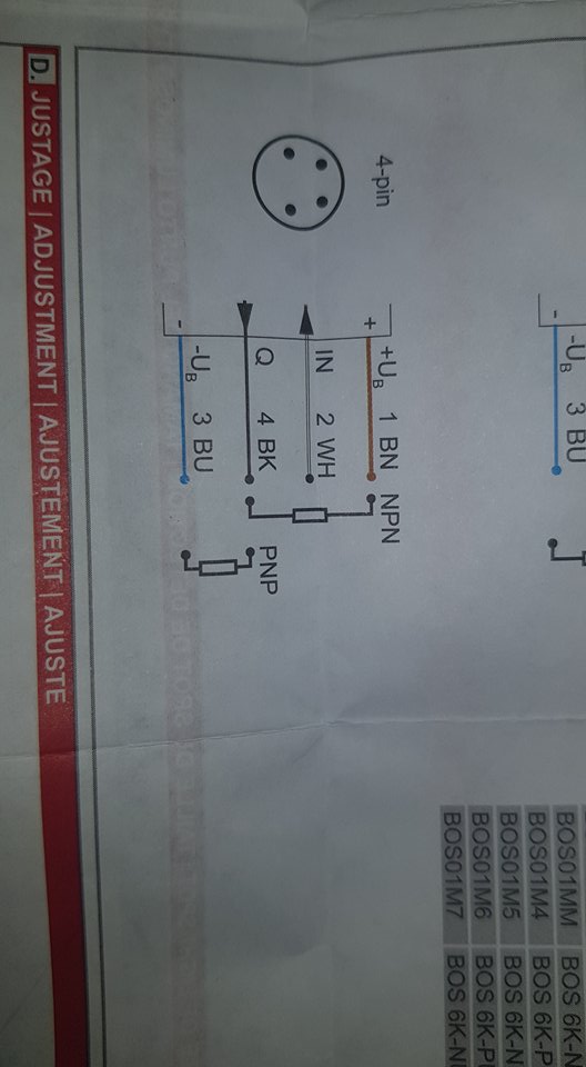

The schematics of the wiring

Its a PNP sensor.

You seem to have the PNP version of the sensor.
Use a voltage divider (two resistors) to drop the 10-12volt output from the sensor (on a 12volt supply) to <=5volt for the Arduino.
Try a 10k resistor between Arduino pin and ground, and a 15k resistor between Arduino pin and sensor output.
Connect sensor ground to Arduino ground.

Let me explain this one more time what I am trying to tell you :slight_smile:
I have an optical sensor and I want to get output from it on the Arduino.
I just don't know how to wire the sensor and I just want the program to output if there is object in the way or not.
In the picture bellow I wrote what the output is being given to me.

The datasheet isn’t very helpful, other than telling you that you’ll need to do some probing to figure the output state under operating conditions.
The Q output of the sensor is what you’re looking for.
It probably swings between the two supply rails (or may be open-collector*).
If you measure between Q and 0V you’ll see the sensor changes.
If it’s pulled ‘high’, you’ll need that voltage divider to get down to 5V
If it’s an *open collector output (or equivalent), you’ll need to use INPUT_PULLUP, or an external +V biasing resistor to see the voltage swing.
