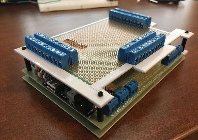

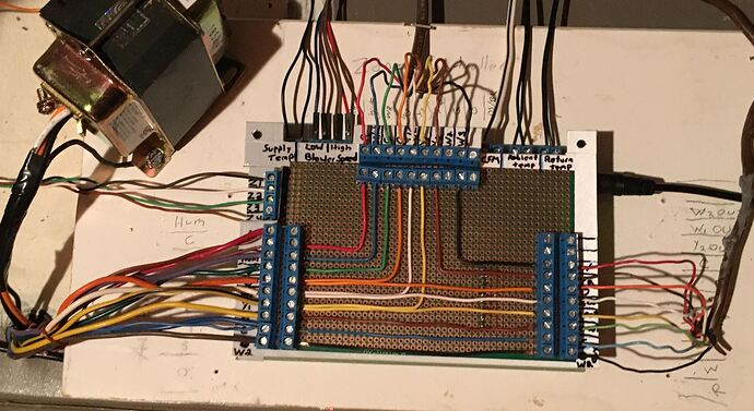

Here is my final schematic ....
And here's what the final product looks like:
