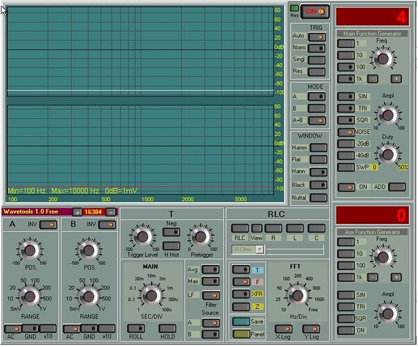

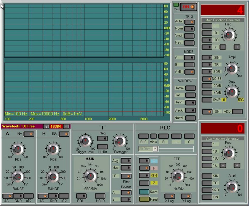

Of course, you can get sound cards that capture at 192ksps @ 24 bit, and software that can use that for a pretty good audio spectrum analyzer. Some include the ability to use one channel as an output to provide a swept sine wave, and the other as an input at the same time. Both your sound card and the software must support this.
This one looks impressive.
Cobracom - Waveguide
Cobracom Oscilloscope PC based
Oscilloscope, Realtime spectrum analyzer, Impedance meter, RLC bridge and signal generator for Windows. Is a Windows application that converts your PC into a powerful dual-trace signal analyzer (oscilloscope, FFT etc...) . Uses your PC sound card as an Analog-to-Digital a Converter to digitize any input waveform and as Digital-to-analog Converter for the signal generator. True 24 bit adc/dac 48K/96k/192k sampes/sec.
