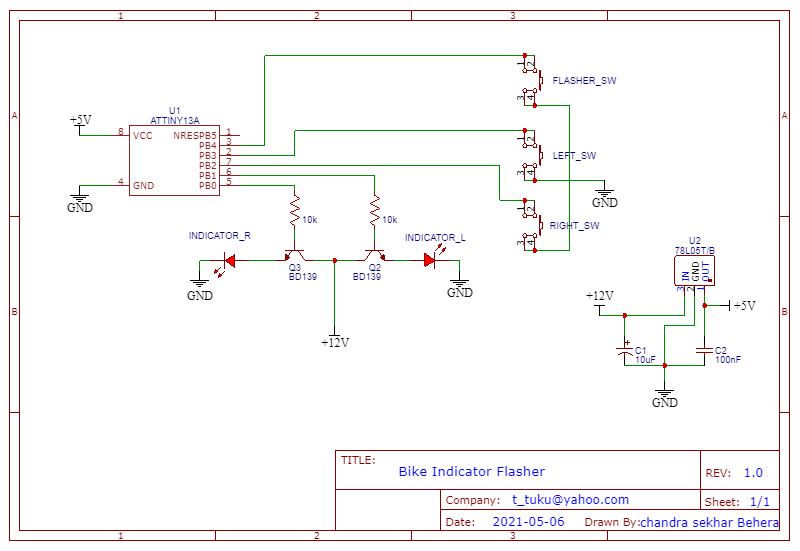

Hi I want to create a project for my bike with ATTINY13 microcontroller. I have two leds for LEFT indicator and RIGHT indicator. and Three Button for Left_indicator, Right_indicator and Flasher_effect.
As soon as any button change, the corresponding led effect should blink. But whenever a large delay type flasher running, the button execution got halt. I had to press more time to see the effect.
I need to change the button function as soon as the button is press...
pls help me out.
attaching the schematic and code for your reference.
