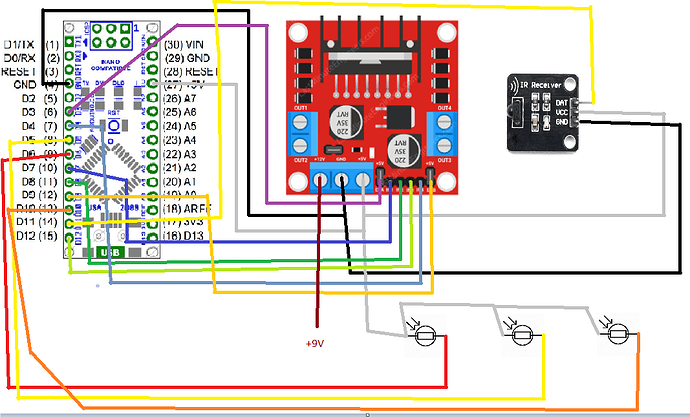

You flaunted the forum guidelines and did not post a schematic. Do you have pull up or down resistors on the button switches? Please post a wiring diagram or schematic.
If those are LDRs on D6,D10 and D5, then you have wired them incorrectly. They need a current source resistor to make a voltage divider. See any LDR input circuit via Google.
Same thing, if they are switches not LDR's. If you made that mistake, please research electronics symbols. Consult the Arduino switch examples and tutorials to learn how to connect and read a switch.

I refuse to talk about anything that is not in the diagram. Please update it to accurately reflect your physical circuit, or my help will end with this post.
You have:
#define RS 8
#define LS 10
#define MS 6
The wiring shows 5, 6, 10.
For an LDR, add a sourcing resistor, feed the junction to an analog input pin, use analogRead then determine if there is reflection or not.
The position of LDR and 10k resistor can be reversed.

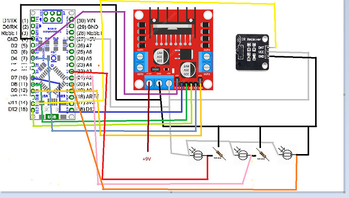

Sorry yah that is an older version of code as I realised one of the sensors wasn't on a PWM pin so I changed it around. I will take a look at everything people have told me too now and try and fix any mistakes.
So are you telling me, both your posted code and schematic were wrong, you knew that and didn't tell us?
No I only changed the problems after I posted it and got a reply back. The PWM port was just a problem I noticed when making the 'uint32_t' fix to the code, it was a silly mistake and obviously must have gotten mixed up during looking at my circuit or something. I would only ask genuine problems I can't figure out myself on this forum.
Are we up to date with everything now, full and actual code and schematic?
Yes, here is the fixed schematic from what I looked at:
And here is the code to match:
