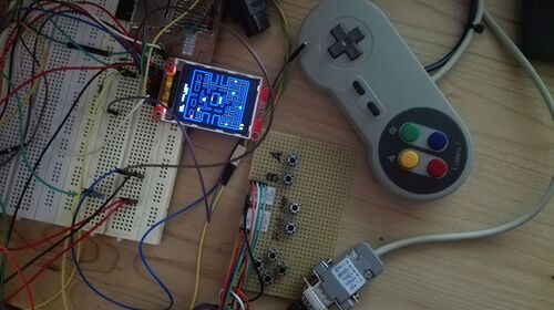

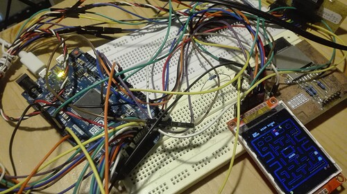

Hi guys,
I want to present my beta version clone of Pacman Game for Arduino Due with ILI9341 tft and VGA lcd support with "ILI9341_due.h" and "VGA.h" libraries. Pacman is playable (with some glichies - because it is in develope state), there is 5 sample levels, you can use both outputs (VGA and ILI9341), controller (KEYPAD) is made from 8 buttons.
Used buttons:
START = Start or pause Game
SELECT = Reset Game
UP, DOWN, LEFT, RIGHT = Direction control
Source:
https://github.com/DrNCXCortex/Pacman-Arduino-Due
Video:
Pictures:
Pacman-Arduino-Due.zip (188 KB)
Looks excellent, nice and smooth and not a hint of flicker. Not tried playing as I only 4 buttons, but cool nonetheless.
Why not add NES controller library and use NES controller? It's got 4 direction, select, start, and 2 more buttons.
Or if Due can't handle any more libraries, use a 74595 serial to parallel shift register to decode NES data and feed 8 lines like the original button controller you have?
Subscribed!
OK I will try it. Give me some time...
OK, NES or SNES Controller is now working with Pacman Game, I used this: Google Code Archive - Long-term storage for Google Code Project Hosting. library (SNESpad 1.3 library for Arduino). And here is updated part code:
