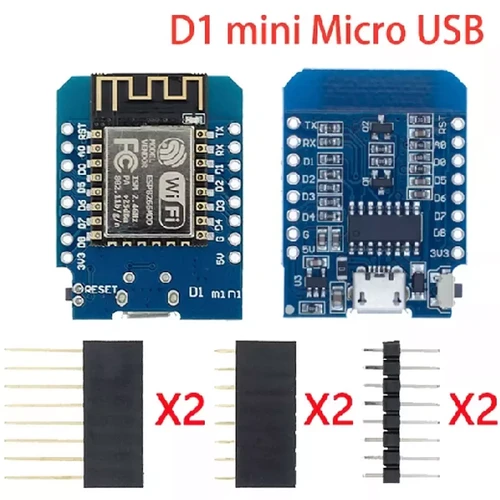

My favourite Arduino compatible board with WiFi is the Wemos D1 mini. However, this has only a small number of pins, so I would probably connect the LCD and keypad via i2c adapters.

Here are some of the components I was suggesting in post #6

Thank you. All I need now is the code to be use in the proect.Is it also possible to use ESP8266 module for the wifi connection?
Indeed!
Start simple, connecting perhaps only the LCD and it's adapter to the D1 mini and get an example sketch working. Then add the keypad and adapter and, again, get an example sketch working.
