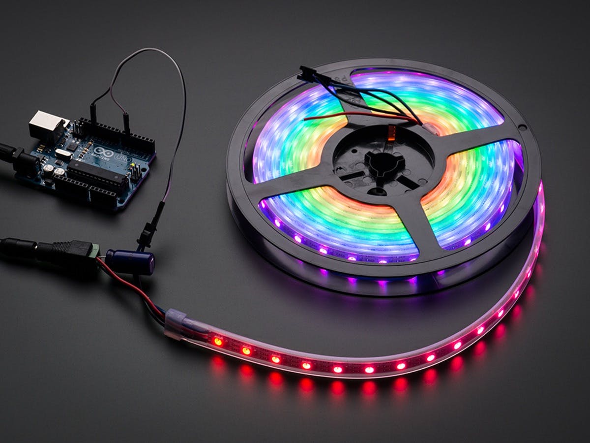

The LED strips might have to go though. 12V logic is... hard to manage. Have you considered NeoPixel?
EDIT - If you used NeoPixel I could build one of these things in a week* for a hundred bucks.
*not including parts shipping
EDIT - Maybe not a week. But still, NeoPixel would make this much easier.
please message me, I do not have my DM permissions yet
Hi @Kylem21
I wrote a tutorial for almost an identical project as what you are asking for.
Because both the WS2812 and IR need strict timing, you will need 2 nanos, one for each. My tutorial explains it all.
