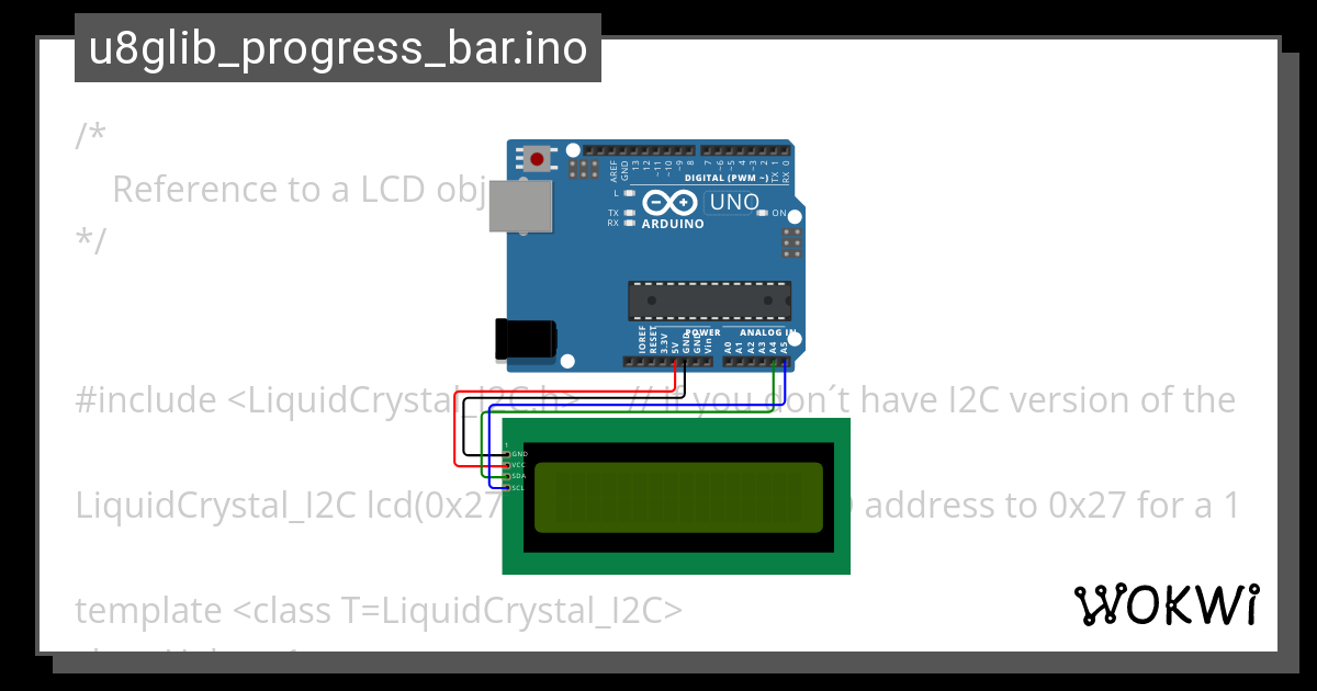

When you use a c++ template you can easily handover also the class type of the lcd object. You dont need to hardcode the I2c library.
Here is a quick example
By the way: most LCD libs are based on the LCD API 1.0 - so you can expect that the main member functions are compatible.
It's done all the time to register callback functions.
That's an impressive simulator.
I haven't really used template classes much, so I'm learning a lot at the moment. But am I correct in assuming that this approach will only work if the display class you template from has a .print method?
I know you said they all should because they are based on the same base, but I'm just trying to understand things here.
So basically the compiler is happy to have the class template code there in the source with a reference to a .print method even though it doesn't know if that code exists, it only checks if the .print code exists if it sees a call to helper.foo and because helper was based on the I2C LCD library, the compiler checks if there is a member function called .print in the I2C LCD library.
Very Interesting.
I suppose it's a bit like prototype definitions. You supply a like of code that says a method or function exists and what type of parameters it takes and the compiler is happy with that even though it hasn't seen the actual code for that method or function yet. And its not until you have a line of code that calls the function declared in the prototype definition that the compiler then checks if that code actually exists.
The example shows basically two things:
  1. how to hand over a reference to an existing object
  2. how to use a template parameter
yes that' correct for this case. The referenced object needs to have all member functions you want to use. Print.h is a very common class. I assume most of the Character-LCD libraries inherit from Print.h - hence it will work.
