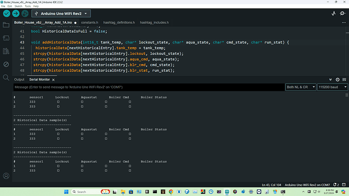

I realized after adding the asterisk [*] to the char function something weird happened.
When changes of states on the digital inputs occurred instead of changing just the next record it overwrote the existing records digital values so all the records had the same value as the last record. The analog input was not affected.
Using the strcpy() mod you suggested gave me the small square blocks again. I also tried it with and without the * behind char in the void function. Unfortunately when I copied the data in serial monitor these small blocks were gone so I added a screenshot.
2 Historical Data sample(s)
#	sensor1      Lockout      Aquastat      Boiler Cmd      Boiler Status
1	333
2	333
1	333
2	333
1	333
2	333

    strcpy(test, "ON");
    addHistoricalData(test);
    sensor_read_1 = true;
  printHistoricalData();
  delay(2000);
OK, is this an improvement? But now I have two data values in each record instead of just one for each time the input changes state.
The values are not overwriting anymore though. :+1: :+1
char test_OFF[4] = "OFF";
char test_ON[4] = "ON";
struct TestData {
  char*  test_OFF;
  char*  test_ON;
constexpr size_t maxCycleCount = 4;
TestData historicalData[maxCycleCount];
size_t nextHistoricalEntry = 0;
bool HistoricalDataIsFull = false;
void addHistoricalData(char* OFF_ON) {
  historicalData[nextHistoricalEntry].test_OFF = OFF_ON;
  historicalData[nextHistoricalEntry].test_ON = OFF_ON;
  nextHistoricalEntry = (nextHistoricalEntry + 1) % maxCycleCount;
  if (nextHistoricalEntry == 0) HistoricalDataIsFull = true;
void printHistoricalDataAtIndex(size_t idx) {
  Serial.print(idx + 1);
  Serial.write('\t');
  Serial.println(historicalData[idx].test_OFF);
  Serial.println(historicalData[idx].test_ON);
Well, the situation seems to be devolving either from my utter stupidity or general state of incompetence.
Making your suggested char array assignment in the struct has allowed a value to pass from 'test' out of the dig input monitoring if statement in the void loop() to the void addHistorical Data.
When printed out on the serial monitor it shows 'ONN' not 'ON' and the other values remain a '0.' I never can generate an 'OFF' state even after changing the pinmode assignment to 'INPUT' from 'INPUT_PULLUP' and adding the requisite external pullup resistor attached to 5 volt pin. I though the input might be floating. I even moved char test down to the void loop().
So things remain wonky .... :cry:
```cpp
const int test_input = 3;
int8_t test_input_state = 0;
boolean sensor_read_1 = false;
struct TestData {
  char test[5];
void addHistoricalData(char OFF_ON) {
  strcpy(historicalData[nextHistoricalEntry].test, OFF_ON);
  Serial.write('\t');
  Serial.println(historicalData[idx].test);
void printHistoricalData() {
  Serial.println(F("\n-----------------------------"));
  if (HistoricalDataIsFull) Serial.print(maxCycleCount);
  else Serial.print(nextHistoricalEntry);
  Serial.println(F(" Historical Data sample(s)"));
  Serial.println(F("-----------------------------"));
  Serial.println(F("# \Data Value"));
  if (HistoricalDataIsFull) {
    for (size_t i = nextHistoricalEntry; i < nextHistoricalEntry + maxCycleCount; ++i) {
      printHistoricalDataAtIndex(i % maxCycleCount);
    for (size_t i = 0; i < nextHistoricalEntry; ++i) {
      printHistoricalDataAtIndex(i);
  pinMode(test_input, INPUT);
  char test;
  test_input_state = digitalRead(test_input);
  if (test_input_state == HIGH) {
    strcpy(test,"OFF");
  if (test_input_state == LOW && sensor_read_1 == false) {
    strcpy(test,"ON");
  delay(2000);
Screenshot of serial monitor output:
This is really perturbing. I specifically referenced your reply when I responded and it still does not attach the response to you. Why does it do that?
Please see response 21.
OMG......OMG.......OMG......OMG......OMG......OMG.......OMG......OMG......
Sometimes it pays to be a glutton for punishment. I feel like I just finished a phreakin'
marathon.
It works. It actually is working!!!!
My appreciation of your willingness to bear with me cannot be overstated.
May the coding gods look favorably on you forever and always.
I gotta go crack open a bottle of vino. ...lol...
p.s. now I will try to add 'timestamping' to the structure. But I promise to
leave you alone. :upside_down_face:
