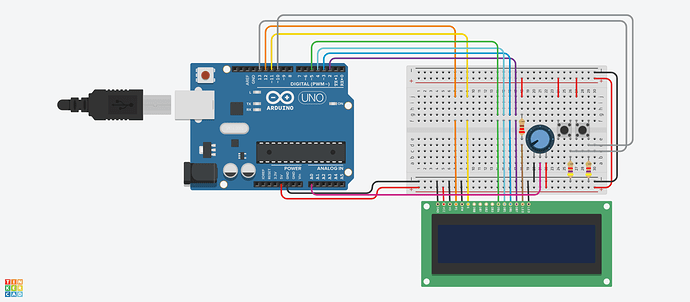

Greetings! I am doing something in this project that when the second button is pressed for 3 seconds it will prompt to a change password where the user must input the old password then the new password if the old password is correct. My only problem is that when the old password is inputted, it automatically updates the old password as the new password. Here's the code and layout in tinkercad

what is not clear to me how does entering characters work?
best regards Stefan
In the layout, I use the potentiometer as its "typing" of letters from a to z plus space. Then I use the concat() to make the inputted char into String and compare it with the current password which is "ab".
English is not my native language so I have to apologize in advanced
The situation that I want to happen is to change the current password. My guess is I have a wrong code here or wrong placement of code here. Which results to not updating the old password with the new password

Major '-' for posting a Fritzing pretty picture. Fritzing pictures are NOT a schematic and many here won't even bother to try to follow the rats-nest of wires. Draw a proper schematic- nothing fancy, even a hand-drawn schematic is better than any Fritzing picture. If you draw a proper schematic I promise that more people will look at your project.
The first thing in your code that stands out is- not a single comment. Anywhere. And, we're supposed to know what you were thinking when you wrote the code? I guarantee that if you revisit the project in a year, you won't know either. Again, if you comment your code to let us in on your thought process, more people will try to assist.
I think this is how the program should work.
The potentiometer connected to A0 is used to change a letter being displayed
The button at D13 is used to select the letter being currently displayed
The button at D10 is used to:
Short press open the Vault Lock if the password matches cond=0
Long press will go to change password. First by entering the old password cond=1
Short press if password matches prompt for new password
Short press to save new password
So to change password the following steps should be done.
  1. Long press D10
  2. Using the potentiometer and D13 to type the old password
  3. Short press D10
  4. Using the potentiometer and D13 to type the new password
  5. Short press D10
To make the program work a new value of cond must be defined. cond=2 is entering new password.
Please try the code below:

Wow! Thank you for this! I actually got it working yesterday and we have similar result!
Here's my version btw
