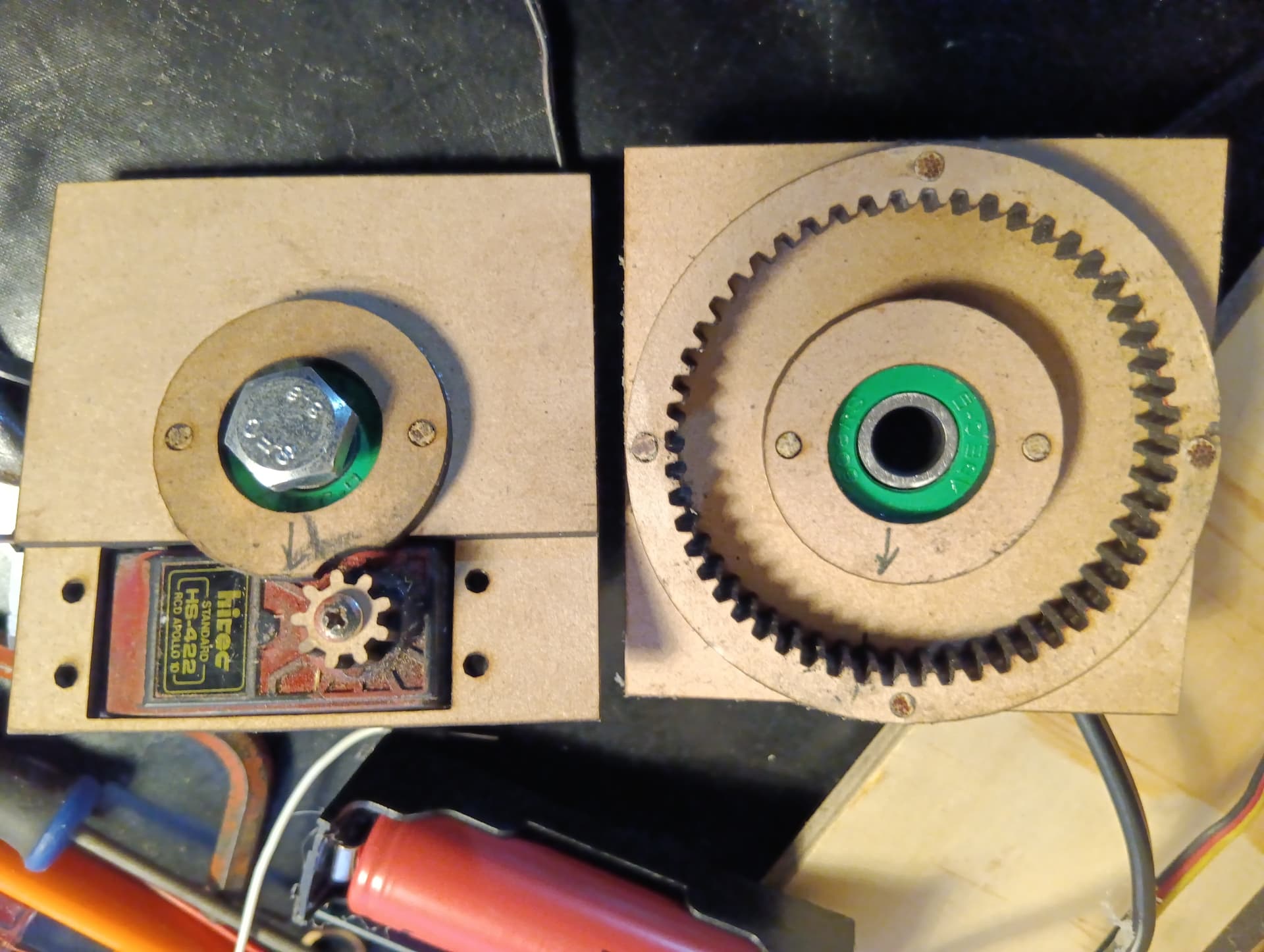

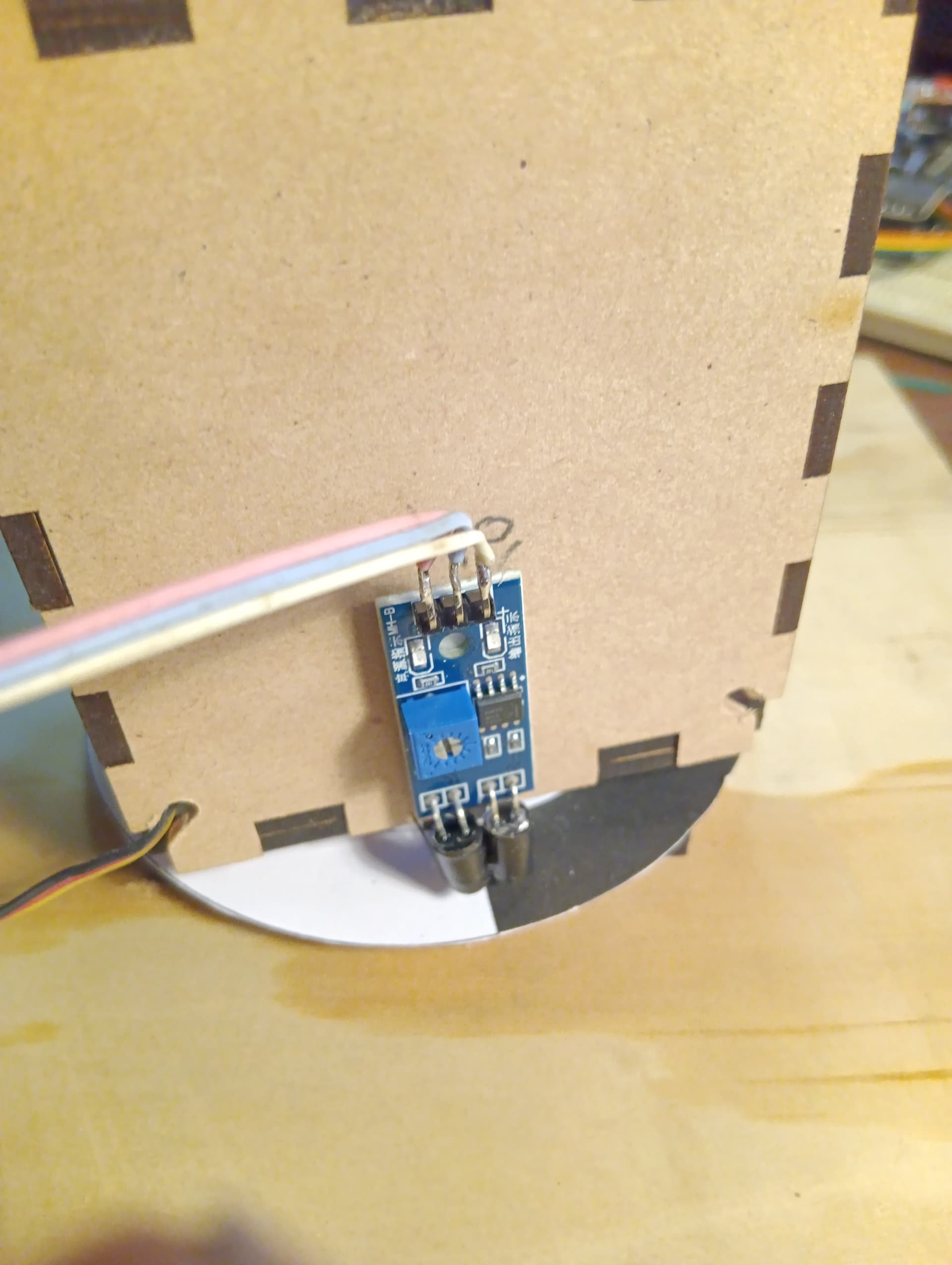

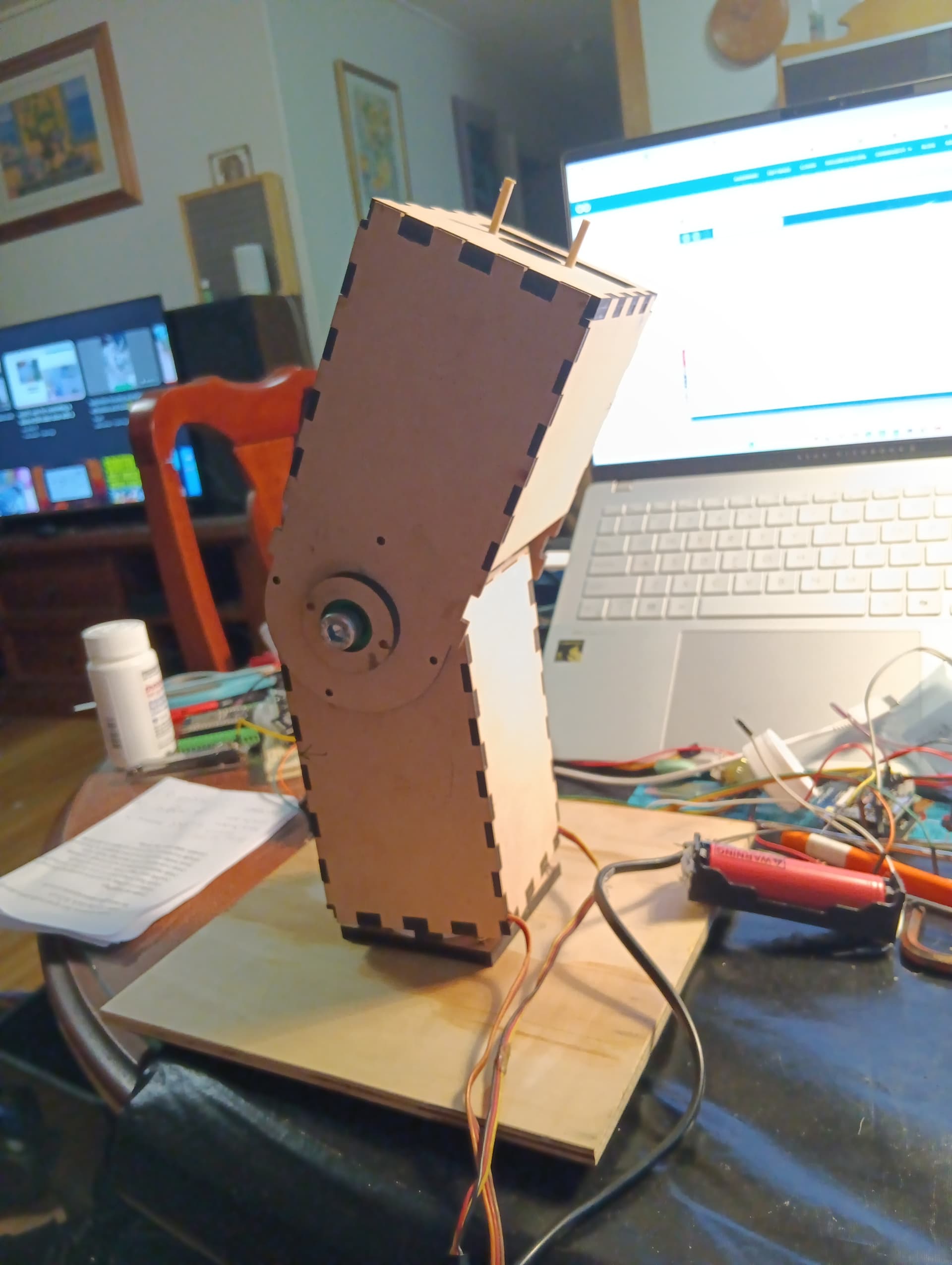

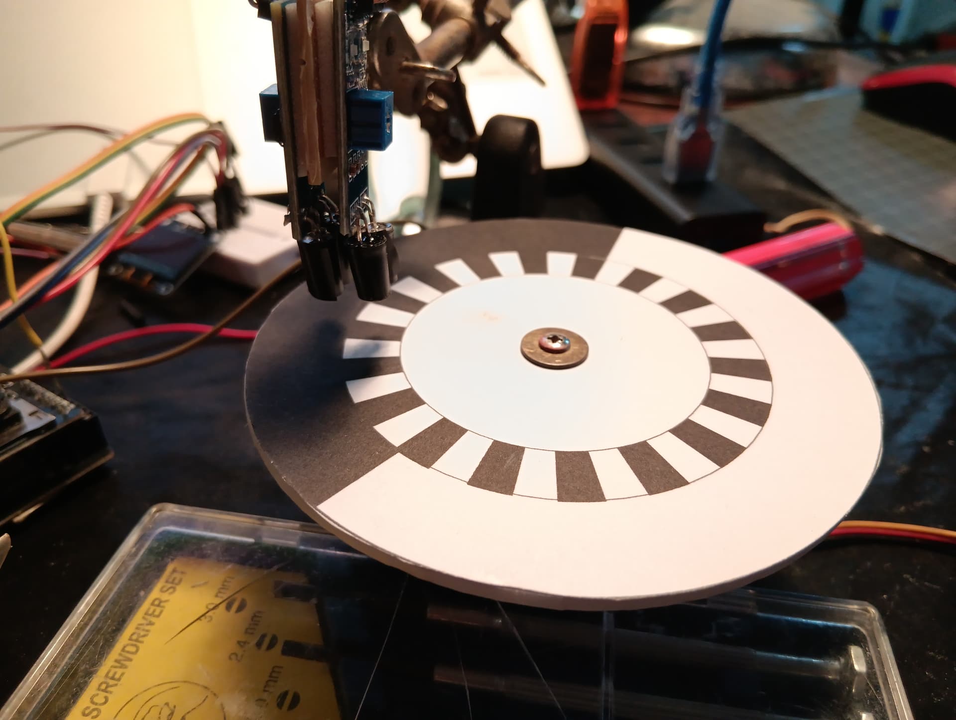

I have designed and Laser cut MDF parts to build Robot arm/autonimous Sentinal. most inexpensive arms seem flimsy and jerky. My design has reduction gears 70 by 70mm + square arms and is using servos modified to be 360 degree. I am designing a position sensor using cheep IR crash avoidance sensors for limit switch and degree counting 10degree. The problem i am a very newby to code writing I usually can cut and paste. but I want to use the PCA9685 I2c Controller but am having trouble finding a suitable sketch using Millis. Using delay the program blocks the IR modules which needs to monitor continuosly. any suggestion for a code download would be apprecieated. at present I only need one servo for calibration and testing position sensing.

Step 2 Once I get the interupt working I am using an IR Sensor to interupt the Rotation By writing 90 Stop to the servo.
Step 3 then read the second IR state to find LH or RH limit.
Step 4 second function My second IR sensor is reading 10 degree change state. 0 and 1
Step 4.5 working out the degree and recording.
Step 5 I intend having a two buttons one to calibrate safe sweep and a second to Home 1/2 sweep angle.
Step 6 when I eventually get all that working implement in my Laser cut Robotarm / Sentinal.

yes correct. but that is what i am trying to fix. using the cheap ir collision sensors and printed (encoder?) i know what i hope to do but programing is a problem for me.
