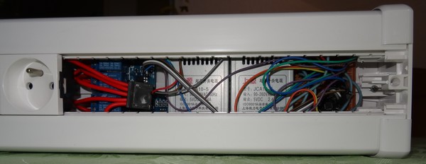

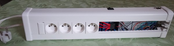

I need to have only one current sensor, for the relay dedicated to heating system.
Firstly i used a couple PCF8574 (relays) + PCF8591 (ACS712) over I2C.
Since i got in trouble with PCF8574 and relays, i replaced all this by a slave I2C arduino pro mini.
It is more accurate for driving the ACS712 over I2C.
8 bits ADC PCF8591 => 10 bits ADC arduino
Also, sensing 220V AC 50 Hz current needs multiple access to ACS712, to get min/max values.
The arduino pro mini handle this.
The main arduino sends an order ("start read ACS712") and asks for value one second later.
An arduino pro mini could handle up to 4 ACS712 with analog inputs (4 = 6 - SCL & SDA).
