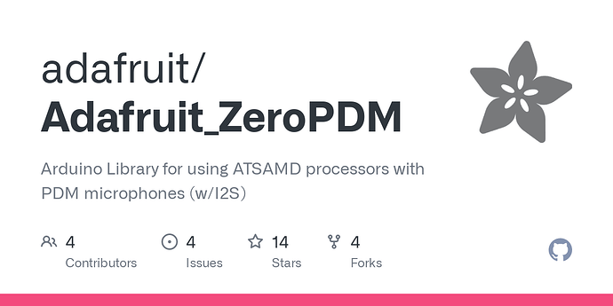

I've a Nano 33 BLE Sense. I'm reading about the PDM sound library:
It's not clear which library this is. In IDE / Manage Libraries, the closest I see is the Adafruit Zero PDM library, with the GitHub repo here:
Is that it? Or is it a different library that's discussed on the first link, one that is owned by the Arduino project?
The API of the Adafruit library seems a little different from what I see on arduino.cc, based on the examples they include, which is why I'm asking.
GitHub - adafruit/Adafruit_ZeroPDM: Arduino Library for using ATSAMD processors with PDM microphones (w/I2S)
You won't find the PDM library in the Library Manager because it is bundled with the Arduino nRF528x Boards hardware core. The reason is this is an architecture-specific library. It is updated along with the hardware core so it would not make sense to update or install it separately from the core using Library Manager.
Florin_Andrei:
Is that it?
No.
Florin_Andrei:
Yes. The Adafruit library is a 3rd party library. Only official Arduino libraries are documented on the Arduino website.
