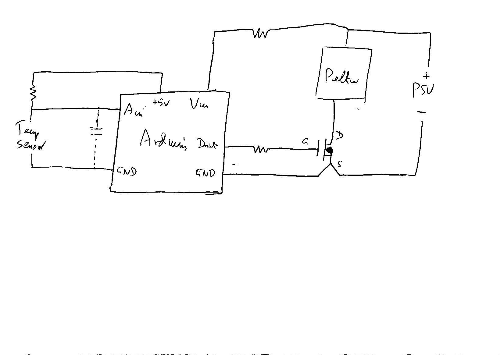

The switch mode power supply to the Arduino is the culprit. No noise when Arduino is powered by a wall adapter. Not inconvenient because I would like to keep adapters / leads to a minimum.
  1. Are you using the default voltage reference, i.e. Arduino +5v?
  2. Is the switched mode supply feeding 5v direct to the +5v pin (as opposed to providing more than 5v into Vin or the barrel jack)?
If the answer to both is yes, then the solution is to use a more stable voltage reference. e.g. the +3.3v pin. if there is no load on that pin currently, you may need to add a 10K resistor between it and ground to get a stable voltage there.
The mosfet source pin should be connected to power supply ground and a single wire run from that junction to the Arduino ground pin.
You shouldn't need a capacitor across the temp sensor, but if you do have one, you should connect the ground side of it to the ground side of the temp sensor (i.e. analog ground), not to any other ground. Depending on the temp sensor, you may need a resistor between the temp sensor output and the capacitor (check the data sheet for the temp sensor).
Thank you. Power supply is 12v to Vin. Reference voltage is 3.3 for the temp sensors, otherwise 5v. I followed your earlier advice and separated the GND's, but need to connect to power supply GND also.
Caps have improved the stability of readings. But noisy in the -ve range. Need to loooy a resistor use.

How are you using more than one ADC reference voltage?
geoland:
See attached for my recommendation on how to connect the power supply. The resistor between the power supply +ve and Vin is optional but may help reduce PSU ripple feeding through to the Arduino. About 47 ohms should do provided that you aren't drawing much power from the +5v line.

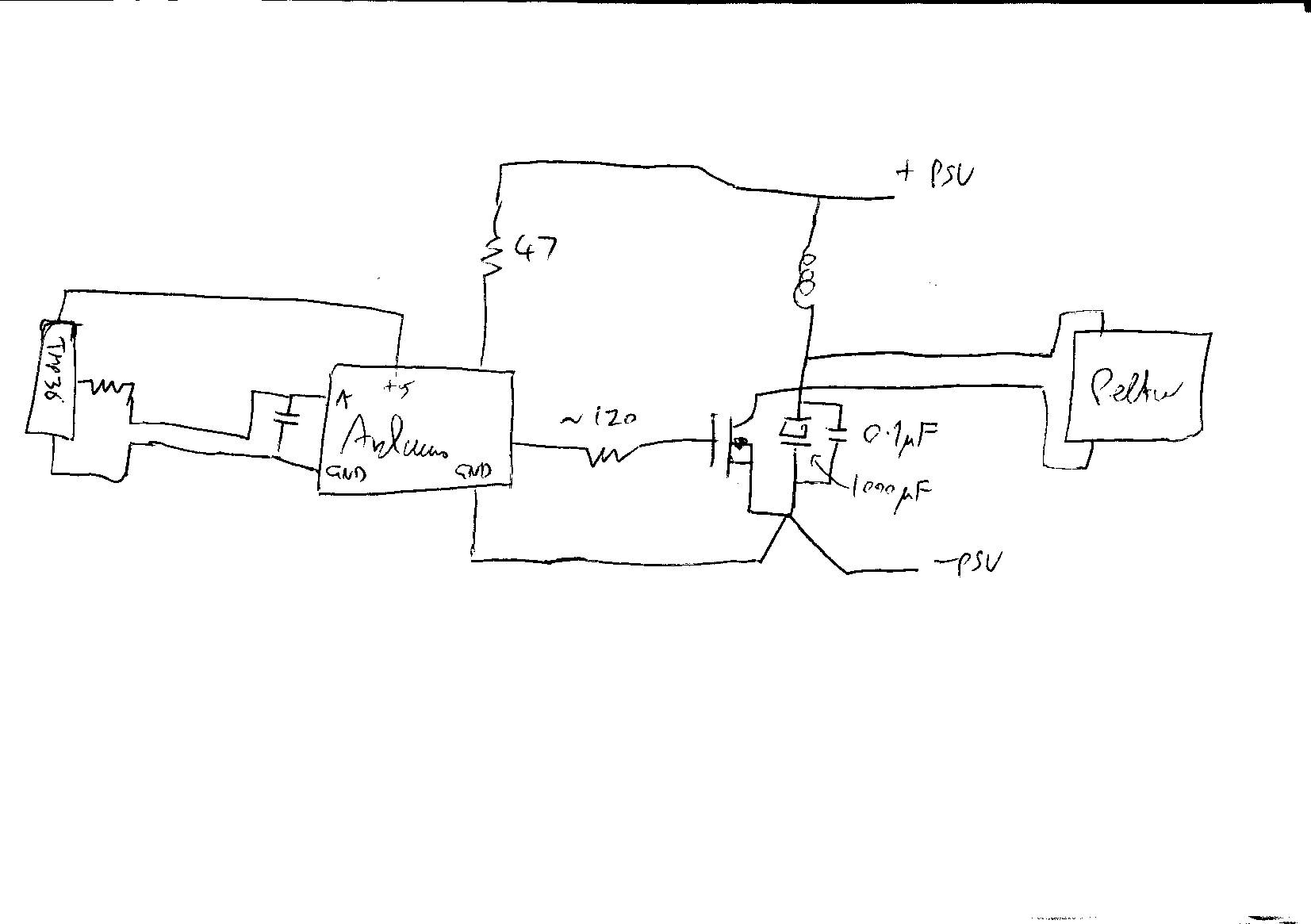

So I need to add A 47R to the power supply line and tie the FET source to power supply GND, which will tidy things up and eliminate the use of wall adapters. There are enough leads to trip over as it is.
Power supply is a 12v 12.5 amp switchmode to supply the Peltier and Arduino board and Equatorial mount. Off the Arduino I am using 5v to power a stepper through an L293D and camera shutter release through an optoisolator, tapping 12v Vin to power an LED array via a power transistor.
Does the temperature reading only fluctuate when the Peltier is operating with PWM, and not when it is turned fully on by doing a digitalWrite(pin, HIGH)? If so:
It's occurred to me that the high pulsed current through the Peltier device may be inducing current elsewhere. See attached for my latest take on the wiring. Try to keep the area of the loop comprising Mosfet source/drain, capacitors, and cables to the Peltier as small as possible (e.g. use a twin cable to connect the Peltier as my diagram infers, or two wires twisted around each other). The inductor between the Peltier/capacitor junction and +ve supply will help stop the switching transients getting outside this loop (use a few turns of wire on a ferrite toroid).
Similarly, keep the area of the loop comprising TMP036 ground and output, Arduino input and analog ground, and the cable between them small. However, if that loop does pick up noise, the resistor and capacitor should reduce it provided the capacitor is close to the Arduino.

  1. Can you answer my earlier question: if you drive the PWM pin permanently high (or alternatively short the source and drain terminals of the mosfet) so that the Peltier is operating continuously, do you get the interference then? In other words, is the problem caused by putting a load on the switched mode supply, or is it caused by the PWM? I'm not sure what the significance of 11C is - perhaps the temperature at which the PWM kicks in?
  2. If the problem is caused by the PWM, add the capacitors between mosfet source and Peltier +ve side as shown in my most recent diagram. If that isn't sufficient, add the inductor. Also make sure you have the grounds arranged as in my diagram, i.e. PSU negative goes to the junction of the mosfet source and capacitors, and a separate wire goes from that point (or very near it) to the Arduino ground. There should be no other connection between Arduino ground and PSU -ve.
  3. If interference from the PWM is still a problem after doing all that, then I guess an alternative solution would be to do software PWM and synchronise the temperature readings with it, i.e. only take a temperature reading just before switching the mosfet. But is really shouldn't be necessary to go that far.

That indicates that the pwm is causing the temp readings to be erratic (a pwm value of 255 turns the Peltier off for 1/256th of the time). Add the capacitors i suggested, and if necessary, the indictor.

Rebuilding the cooling circuit according to my diagram should help stop the Peltier PWM interfering with the temp reading, but will do nothing about the LEDs. What code do you use to control the power transistor that switches the LEDs?
ajofscott has mentioned the possibility of ground loops, and this is certainly a possible source of problems. The switching PSU probably has the negative output connected to mains ground, so if the Arduino is controlling anything that also has a connection to mains ground, you will have a ground loop. If this is the case, it's probably not safe to disconnect either the PSU or the equipment from mains ground, so the best solution would be to use optical isolation between the two.
As for whether or not Peltier devices tolerate ripple or PWM, I have no experience in this area, however you might like to read item 41 on page http://www.tellurex.com/technology/peltier-faq.php.

From your description, you have two separate issues:
  1. LED chain not behaving as it should, even when the Peltier is disconnected. As you haven't said what controls the power transistor that switches the LED, it's hard to say why, although if it only occurs with the switching PSU connected then ground loops may have something to do with it.
  2. Peltier PWM affecting the temperature reading.
I suggest you sort out (1) first. When you have done that, careful attention to the Peltier drive circuit decoupling and wiring along the lines I suggested should resolve (2).
Note the 0.1 ?F bypass capacitor on the input. This capacitor should be a ceramic type, have very short leads (surface-mount is preferable), and be located as close as possible in physical proximity to the temperature sensor supply pin. Because these temperature sensors operate on very little supply current and may be exposed to very hostile electrical environments, it is important to minimize the effects of radio frequency interference (RFI) on these devices. The effect of RFI on these temperature sensors specifically and on analog ICs in general is manifested as abnormal dc shifts in the output voltage due to the rectification of the high frequency ambient noise by the IC. When the devices are operated in the presence of high frequency radiated or conducted noise, a large value tantalum capacitor (±2.2 ?F) placed across the 0.1 ?F ceramic capacitor may offer additional noise immunity.
Taken straight from the sensor datasheet.
I saw no decoupling at the sensor in the camera. The camera its self is an EMI generator. Probably most of your random readings are from the camera's electronics, the probe cable should be a shielded cable such as a 2 conductor microphone cable. If you used unshielded wire your arduino is hearing "hum" from every powerline in the house. Decouple the analog signal on the Arduino end, 15K between Arduino and sensor Vout pin with 100uF on the analog input pin to gnd. I downloaded your code and noticed you have no equasions correlating Q to voltage, nor any establishing a linear line to setpoint error.
Summary: Sensor issues are installation related, decoupling will resolve these, better math will resolve control efficiencies of the TEC along with true DC drive of the TEC.
