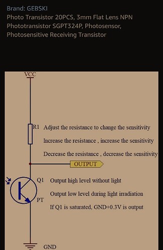

But when I get my photodiodes, will I get false triggers every 60 times a second due to flickering lights?
Someone mentioned that better/new household lighting is at 120hz, they simply have LEDs wired both ways positively and negatively, would that be better room lighting?
That is one of the reasons for buying IR phototransistors.
Wouldn't phototransistors also have react to flickering overhead lights?
Oh boy, the plot thickens, there are two wire and 3 wire phototransistors. I thought all transistors were 3 wire...
Very interesting, just buy tweaking the wiring, with phototransistors, you can sense when the car breaks the beam or enters the beam? So this choice would affect when the digital interrupt fires.
Can choose to trigger the interrupt on a rising edge, falling edge, either edge, or when the signal is low, depending on specific requirements.
A disadvantage is that I must tune the trigger with a resistor and a constant light source via a gantry.
However by having an interrupt triggered on either edge, I could determine the transit time efficiently for trap speed.
With an analog input, it can self tune to some extent. Currently in my program, I sample the sensor on startup. I might get away without having a gantry?
So engineering trade offs.
