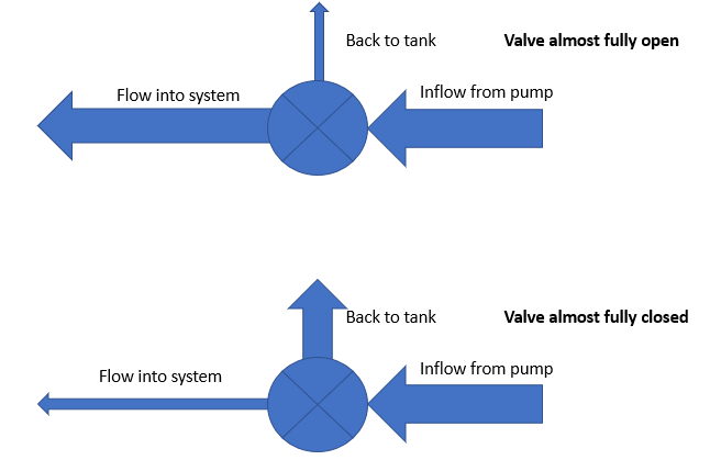

Hello Community,
I have a question regarding a process control and I am searching for a suitable strategy.
Description:
I have a hydarlic system which I want to control. Sensor inputs are pressure and flow rate. Controlled part is a valve. To control the valve I can apply either positive or negative voltage to the motor of the valve. (positivce opens, negative closes) The circuit to perfom this is already in place. I have to pull one pin high to open and another one high to close it (H-Bridge circuit).
The needs about 15 seconds to reach full open position (from fully closed). At high pressure rates, the open/close timing needed is in the range of tenths of milliseconds to reach.
Desired output:
The “setpoint” of the system is the flowrate. I set the rate to a certain value and the valve should act accordingly (either open or close) to reach the setpoint within a certain range/hysterisis (+/- x).
Problem:
I’m now searchingfor different suitable strategies to solve this problem.
Bang-Bang controller --> Due to the time lag in the system (flow rate is not responding instantly I always over/undershoot)
PID controller --> I thought of a PID controller and correct tuning for the system. My problem here is that I do really know how to approach this. A PID controller gives an “analog” ouput which I could translate somehow to a very large PWM signal. But the system needs to set two different pins. If the actual flowrate is below the setpoint the valve has to open --> open_PIN HIGH) if the rate is above the close_Pin has to set HIGH.
The problem with the two Pins is solved already, as I translate OPEN (1) or CLOSE (0) to controll the H-Bridge already.
I would need some kind of a PID controller that would give me a ouput like
OPEN for x sec
CLOSE for x sec
if in a certain range do nothing
The time lag in the system and the large opening and closing times worry me.
Does anyone have a suitable strategy and perhaps some samples or links where to dive deeper?

The valve maintains its position when no voltage is applied.The pressure drops when valve is closed and rises when opened. Pressure changes are due to the fact that it is a kind of a mobile system and the pump is not that stable (especially with high pressure) - also its necessary to vary the flow rate quite often - so the setpoint changes quite a few times. The flow rate has to be stable over a long period of time (hours).

Basically what you are saying is correct. I do not have any feedback on the position from the valve itself. In principle its just a "dumb" motor controlling a piston in the valve itself and the relationship of flow and pressure is of course not linear. I measured the curve and it an exponential function flattening at the end.
I am using a proportional valve. The pressure and flow from tank/pump always remains the same (exept for fluctuations) and the valve has one inlet and two outlets. One into the system and one back to the tank. I am measuring the pressure and flowrate only after the valve.

Yes, this is how I understand it as well. There is some complicating issue of the inlet pressure to the pump having variations, and its not clear how fast they occur or persist, and how much the valve position needs to move to accommodate these fluctuations in order to maintain constant outlet flow.
What's not clear to me is what variation in outlet flow can be tolerated and how fast the flowrate needs to be brought to the desired value. If the flow can be slowly ramped up from the valve closed that is a good way to go.
It would also be possible to store a table of valve positions for flow rates, and open to some initial value before fine tuning the position.
I would hope to see some more data about how the flow rate varies over time with the valve at a fixed position and how the flow rate varies from that with different timed moves to open and close from that position.
