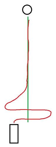

Unfortunately, the boat was unable to go straight. The boat was in a huge zigzag, there was not a second when it was going straight. The P value didn't seem to change the behaviour of the rudder, but if I remember correctly, with a high D value the rudder started to jerk like crazy. I had given up completely, but tried one last random value:
P=1.2 I=0.2 D=0.2
And it was almost a perfectly working control. The movement of the boat looked like this:
At the start there is a huge overshoot in both directions. Even when the boat is almost perfectly on course. If I can fix this, the control would be perfect.
But I don't know what's causing these two overshoots:
  • It requires fine tuning of P, I, D
  • Wind-up occurs and this should be handled. However, it is interesting that this is not the case in the later stages.

It seems you chose too large values for P and/or I and/or D. That results in an overshoot.
Also you might need a smoothing filter before sending your measurements to the PID. The D action may cause instability if there is noise on the sensor values. You can also set D to 0 to eliminate this problem. Nothing wrong with a PI controller if it makes you reach your goal...
Best would be to record values of error, p, i and d along the track. That would give you insight on the main contributor to the signal sent to the actuator.
You may want something different for startup. I expect you're getting integral windup when you switch to auto and the PID tries to get you on course. Perhaps use a second PID to get your cross track error down initially and then use your original to stay on course.

After starting the autopilot, I noticed that my boat hardly turns left at all. If the target is to the right, it turns over it, then only very slowly, after a very long time, turns back to the left, and only then reaches the target heading.
So there is a problem with the left side.
The servo that moves the rudder is not installed perfectly, so although the centre point is at the 1500 PWM value, it reaches the final rudder position to the left sooner, so I had to lower the limit.
int rudderleft=1300;
int rudderright=1900;
int ruddercenter=1500;
So, with a centre position of 1500, you only need to move 200 to the left of the centre position, and 400 to the right, to turn left and right at the same angle.
Outputtemp=map(Output,-180,180,rudderleft,rudderright);
But here the value returned from the PID is evenly split between 1300 and 1900, so I assume that if I should go straight it will be 1600, and if I should turn a few degrees to port it will still read almost 1600, which would still turn the boat to starboard?
The interesting thing is that sometimes it works perfectly.

Real boats have asymmetries too. The rotation of a propeller and the interaction of the spinning water with the hull above the propeller can induce nonlinear behavior.
Like the first term in a Taylor series, PID can work pretty well controlling the error from a setpoint as a first order linear system. If the nonlinearities in the sensor or control are significant, you can transform them before or after the PID controller. PID is assuming linearity, but you can transform nonlinear terms to linear.
It is unclear what you are asking, but maybe something like this would transform the control output to have two different slopes:
  Outputtemp=(Output < 0 ?
               map(Output,-180,0,rudderleft,ruddercenter)
             : map(Output,0,180,ruddercenter,rudderright)) ;
(Edited days later to replace zeros in the RHS with ruddercenter. My zeros were horribly wrong. See far below in the thread. )
