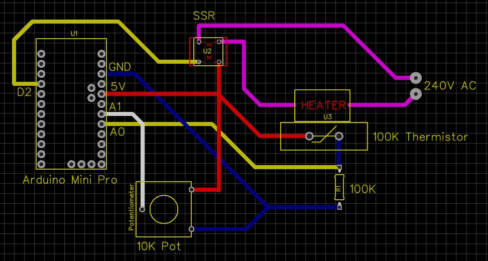

PID with Hair Removal
Hi Guys, I am trying to build a PID controller that will run an element connected to an SSR. I used the PID Adaptive Tuning Example as a start point however what I am having issues with is overshoot.
The element is a 200W ceramic element connected to machine aluminium slug. there is enough material there to be able retain heat for a fair amount of time but what I am getting is a huge amount of overshoot.
For instance if i turn the 10K pot up and adjust the set temperature to 119 degrees (or there about) i get an overshoot of 10 or so degrees.
Below is the log of what I am getting as the temperature climbs but i am not sure what I should be adjusting to reduce the overshoot as the temperature climbs.
Any suggestions as to what to tweak would be greatly appreciated as I think i have lost a few more hairs from trying to work this out. The good news however is that once the peak is reached the unit cools back down and sits at the set temperature quit well however I would rather not exceed the set temperature on its way up for this project.

#include <PID_v1.h>
LiquidCrystal_I2C lcd(0x3F,16,2);  // set the LCD address for a 16x2 line display
#define PIN_INPUT A0
#define PIN_OUTPUT 3
#define ThresholdPin 1             //Analog pin temp pot connected
//Define Variables we'll be connecting to
double Setpoint, Input, Output;
//Define the aggressive and conservative Tuning Parameters
//double aggKp=60, aggKi=0.2, aggKd=2;
//double consKp=1, consKi=0.005, consKd=0.25;
double aggKp=16, aggKi=0.2, aggKd=2;
double consKp=6, consKi=0.005, consKd=0.1;
unsigned long  modelTime, serialTime;
//Specify the links and initial tuning parameters
PID myPID(&Input, &Output, &Setpoint, consKp, consKi, consKd, DIRECT);
double Thermister(int RawADC) {
 double Temp;
 Temp = log(((10240000/RawADC) - 10000));
 Temp = 1 / (0.001129148 + (0.000234125 + (0.0000000876741 * Temp * Temp ))* Temp );
 Temp = Temp - 273.15;            // Convert Kelvin to Celcius
 //Temp = (Temp * 9.0)/ 5.0 + 32.0; // Convert Celcius to Fahrenheit
 return Temp;
  pinMode(PIN_INPUT, INPUT);
  pinMode(PIN_OUTPUT, OUTPUT);
  Serial.begin(57600);
  //initialize the variables we're linked to
  Input = analogRead(PIN_INPUT);
  Setpoint = 900;
  //turn the PID on
  myPID.SetMode(AUTOMATIC);
  serialTime = 0;
  lcd.init();   // initialize the lcd
  lcd.backlight();
  lcd.clear();
  lcd.setCursor(0,0); //Start at character 0 on line 0
  lcd.print(" SET  TEMP   OUT");
  Setpoint = map(analogRead(ThresholdPin),0,1023,0,1023);
  double gap = abs(Setpoint-Input); //distance away from setpoint
  if (gap <= 10)
  {  //we're close to setpoint, use conservative tuning parameters
    myPID.SetTunings(consKp, consKi, consKd);
     //we're far from setpoint, use aggressive tuning parameters
     myPID.SetTunings(aggKp, aggKi, aggKd);
  myPID.Compute();
  analogWrite(PIN_OUTPUT, Output);
  if(millis()>serialTime)
  //lcd.print("SET  TEMP  OUT")
  lcd.print("                ");
  lcd.setCursor(0,1);
  lcd.print(Thermister(Setpoint), 1);
  lcd.setCursor(6,1);
  lcd.print(Thermister(Input), 1);
//  lcd.setCursor(0,1);
  lcd.setCursor(13,1);
  lcd.print(Output, 1);
  Serial.print("Set Point: ");Serial.print(Thermister(Setpoint), 2); Serial.print(" Thermistor: ");Serial.print(Thermister(Input), 2);  Serial.print(" Output :");Serial.println(Output, 2);
  serialTime+=1500;

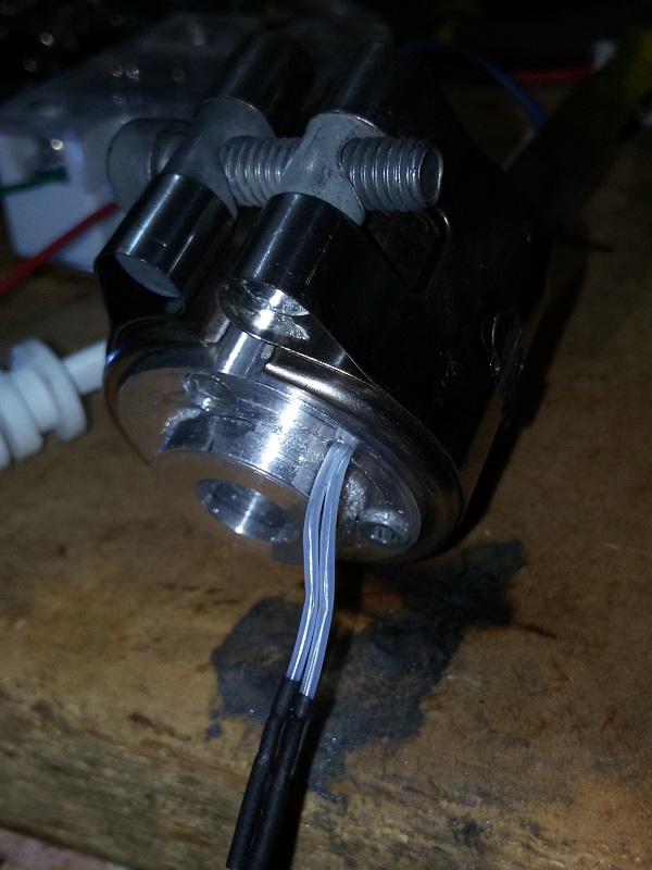

Where is the thermistor positioned with respect to the heating element.
If it only over shoots on warm up, it sounds like the thermistor is not close enough to the element.
On warm up you may have a temperature gradient (difference) between thermistor and element.
When the thermistor gets to your setpoint, the element is at a higher temp, so it soaks through when the element is switched off.
Once everything is at working temperature, you do not have a gradient.

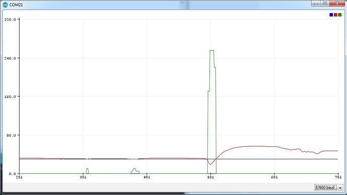

Attached is a chart showing what I am geting
Blue is the Set Temperature
Red is the Thermistor
Green is the Output
It was stable then I hit the head with some spray nitrogen to drop the temperature, As you can see it over compensated quite a bit.
Also attached is a photo of the element with the thermistor attached. the thermistor is about 15mm deep in to the aluminium.

You are using analogWrite to control your SSR.
Won't work the way you think, you need phase control to give you variable element power.
The element is either ON or OFF.

No it won't, the SSR is conducting a 50 or 60Hz AC current.
The PWM from pin3 is 490Hz.
The SSR has a triac in it, once its switched ON it will not turn OFF until the AC Current drops to zero.
This is up to 10mS or 8mS later.
490Hz is expecting the SSR to respond in 1/490 = 2mS
The 490Hz will in no way be synced to the 50 or 60Hz
You cannot switch an SSR On and Off at 490Hz with variable duty cycle.

Yes, starting to think I may need to make an opto-isolated SCR circut for this instead of using a SSR unless as has been suggested i use Bang Bang control or capture the output and use that to slam the SSR on and off.
