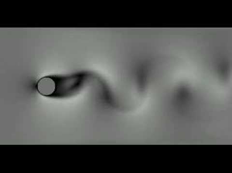

If you put a smooth round tube in moving fluid, it will generate a street vortex:
It can be a string and the force will vibrate the string. At each end there will be vibrating pull.
It can be a tube, the tube will experience vibrating force.
It can be cables on a suspension bridge and at least one big bridge fell apart because of it.
